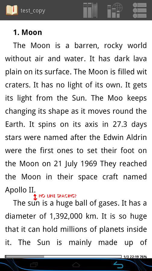

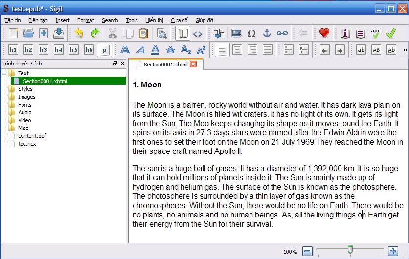

Question Add line spacing between paragraphs?
ex, in sigil (pc):
i'm newbie in this, please help me how to fix it

Looks like your epub reader has it's own ideas about paragraph spacing and first-line indents.
If you supply no styling, you'll always be at the mercy of your reader's settings/defaults. And even then, readers like Moon are often set to override a document's styling by default.
Use ADE to see if your epub is behaving the way you want it to. If it is, and your preferred reader app STILL doesn't show you what you expect to see, then you probably need to experiment with your reading app's various override settings.

The key word you want is: Paragraph margin Top or bottom controls the space between adjacent blocks (paragraphs are not the only block type in use). I use margin-top: to do this as it sometimes eliminates a last paragraph followed by a screen blank page condition.
Line-Height is the spacing within the paragraph (block)
FYI If you converted with Calibre you get an either/or choice: Indent and no margin control or no indent and margin control

Thank you, guys. I guess problem here is my epub reader. I changed into using moon+ reader and now it's ok
