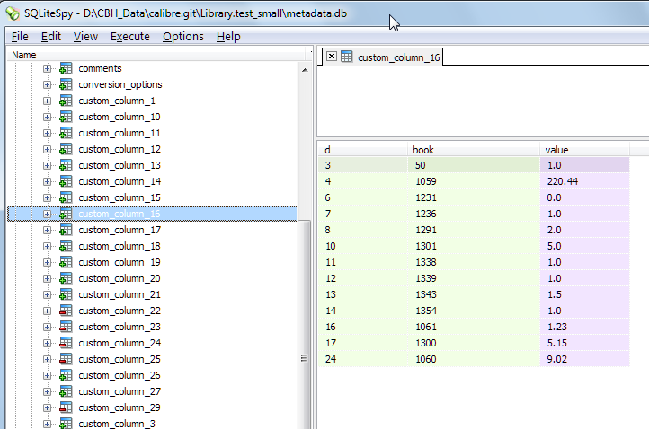

  1. Look at the db with SQLiteSpy. Find a float custom column. Image is below.
  2. Change a value in calibre, in this case 9.01 becomes 9.02
  3. Look at the db again. The value has changed and there is no duplicated row.
What are you doing that is different?
I also note that the table has a UNIQUE constraint on the book_id, so the db itself should toss exceptions in the case you describe.
