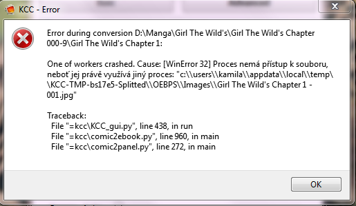

Hello, I keep getting an error when converting in webtoons mode, doesn't happen with normal mode. Tried different computers and different source files, always got the same error. Any idea what is causing this? Thanks.

Known bug. It will be fixed in next release.
Stll waiting for PyQT 5.2.1. When it will be out - I'm releasing new version.
