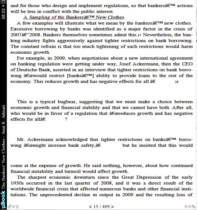

I downloaded µBook reader and gave it a PRC, I saw no cover nor any TOC, and even worse it also displayed lots of 'rubbish' see attachment. The same PRC looks fine in Mobipocket Reader. Also see https://www.mobileread.com/forums/sho...35&postcount=9
It seems to me that all of your problems lie with the µBook reader. You're either going to have to use another reader or put up with µBook's idiosyncratic rendering of anything but plain text. Given µBook hasn't been updated since Oct 2010, it also seems to me that its unlikely that it'll ever be fixed.
