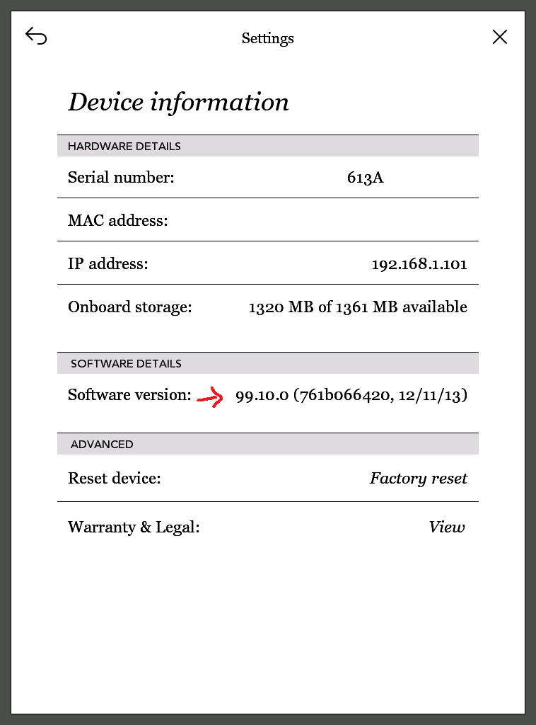

teste prevent firmware update
# Firmware 3.1.1 (761b066420)
<Patch>
patch_name = `prevent firmware update`
patch_enable = `yes`
# alternative 1
#change `5.0.0` , `99.10` , `999.9` or similar
replace_string = 01105C10, `3.1.1`, `99.10`
# alternative 2
#replace_string = 01106BB0, `https://api.kobobooks.com/1.0/UpgradeCheck/%1/%2/%3/%4/%5`, `https://api.kobobooks.com/1.0/UpgradeCheck/%1/%2/%3/9.9/N`
# alternative 3
#replace_string = 01106BB0, `https://api.kobobooks.com/1.0/UpgradeCheck/%1/%2/%3/%4/%5`, `https://api.kobobooks.com/1.0/UpgradeCheck/%1/%2/k/99.9/N`
</Patch>
I tested and it's working ...
but question:
this code can cause problems with account kobo (blacklist) or device serial number ??
sorry English (using google translator)
but question:
They can cause your problems, but I am not sure they are interested in doing so.
With alternative one, you send a fake version number together with your real device serial number. Therefore, this is very easy to detect. With alternative two and three, they have at least to investigate the server logs a little bit more.
With alternative one, there might be another problem. This version number might be used for the actual sync, and for the sync it might be important that the real version number is know, because of changing database format or something like that.
