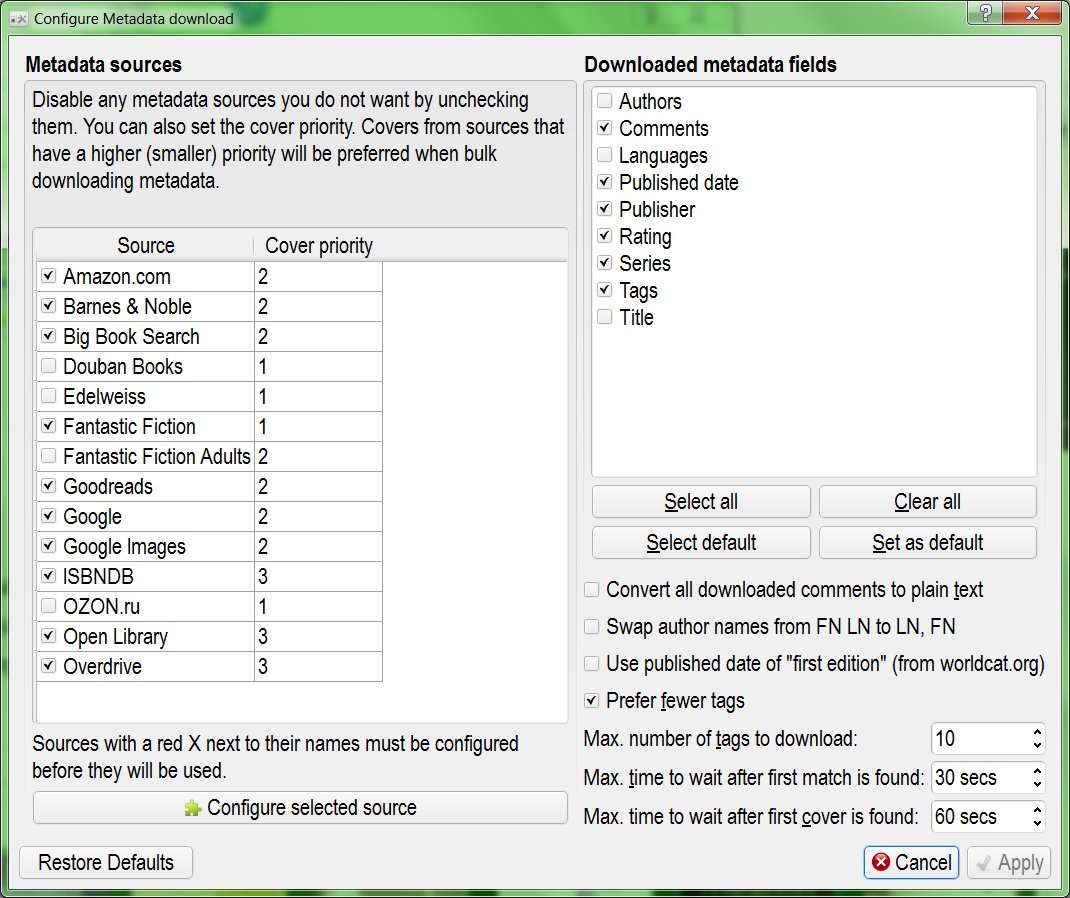

Each metadata source also has a (fine tune) configuration
1st step is click the
Preferences:Metadata Download:
On the Right is the overall 'allow' any metadata data list.
On the left is the Allow (use) sources list
now look at the bottom. See the button with the green puzzle piece?
That one allows you to fine tune by each source.
I hate the ratings from source X, so I remove the ratings tick from there after I select Source X above.
I only want Series info from Source G, so I remove the series ticks from every other source (tedious )
That is how you configure Metadat downloads.
DTW, some Metadata sources come from User Installed (see Preferences: Get Plugins) source plugins. You may want to use one of those.

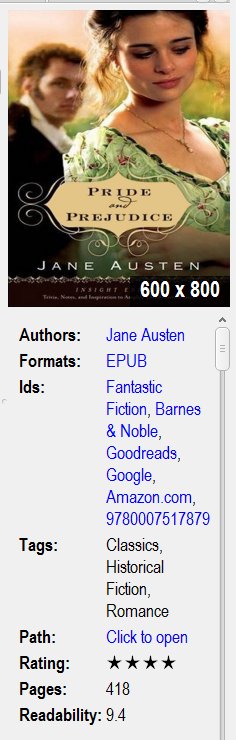

The only place I see in calibre an ISBN link is in the book details pane. Clicking this link does not launch a search of Worldcat but takes you to the book on the Worldcat site. If I click on the Goodreads, Amazon.com, Google Books, Fantastic Fiction or Barnes & Noble links I am taken to the same book at their respective web sites.
These links are only there because when I do search and download metadata I use various metadata plugins as sources.

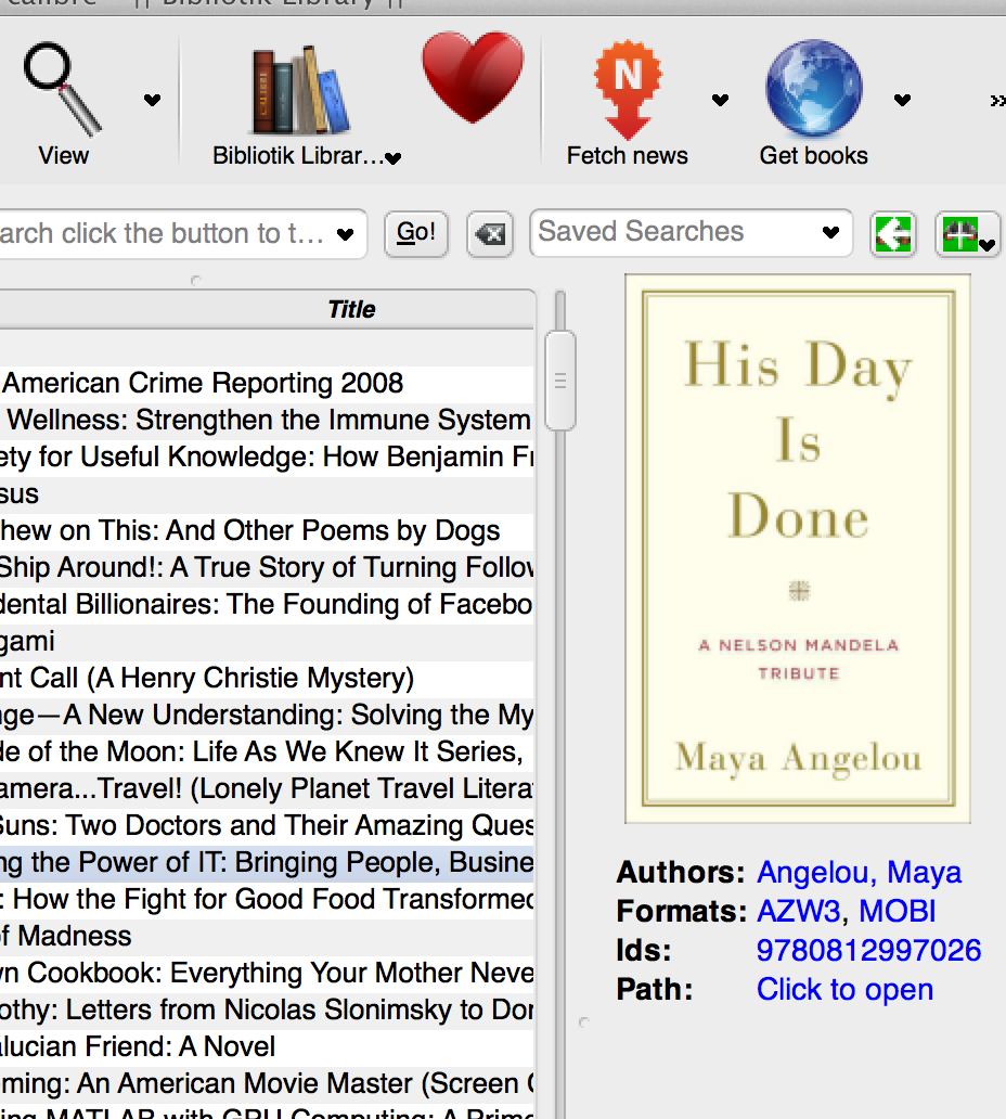

The field isn't titled as 'ISBN', but it's an ISBN number. This shows up (for me) in the main screen of Calibre.

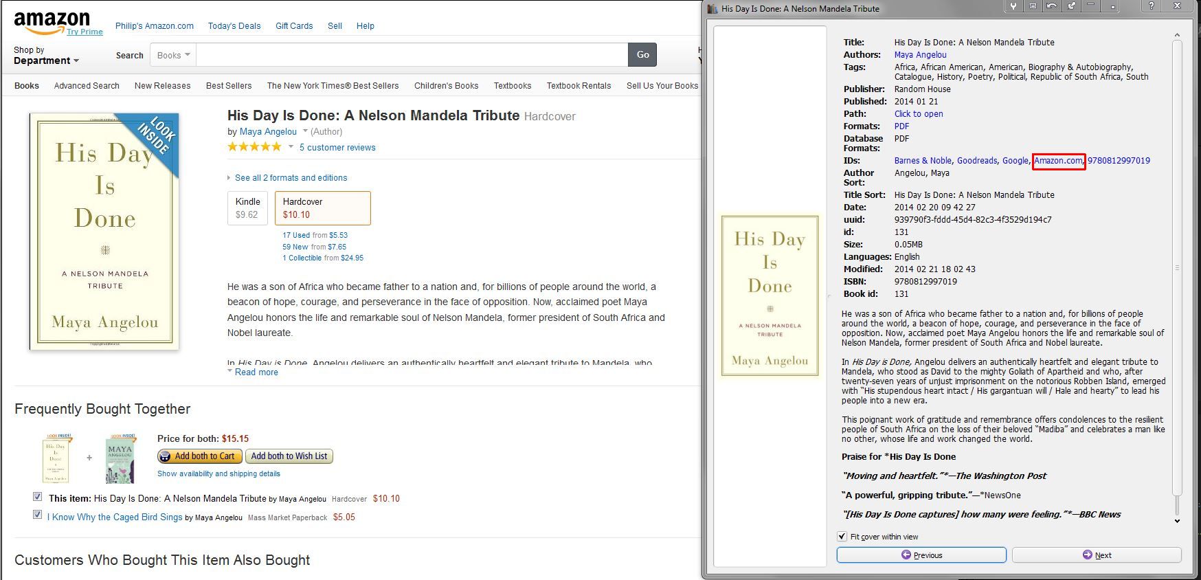

@klieber - if you do a metadata download on that book (press ctrl/D) then you should get the a link for Amazon alongside the ISBN - if you click on it you will get the Amazon page for the book.

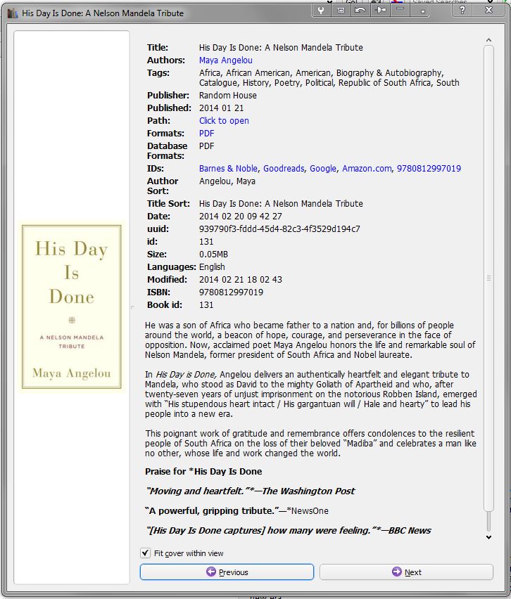

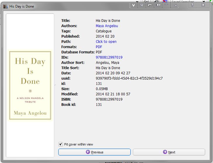

1st attachment shows book information (press i) as you have it
2nd attachment shows book information after a Ctrl/D and I accepted the data
3rd attachment shows book information in my browser after I clicked on the blue Amazon

You can also load the links in the edit metadata manually. The below are metadata entries in the ids section of the edit metadata that could create links in book details to take you Jane Austen's Pride and Prejudice in various web sites (Worldcat, Amazon, Barnes & Noble, Fantastic Fiction, Goodreads, Google Books)
isbn:9780007517879
amazon:0486284735
barnesnoble:w/pride-and-prejudice-jane-austen/1002057084
ff:a/jane-austen/pride-and-prejudice
goodreads:9531356
google:20wyXwAACAAJ
I didn't enter any of these manually they were all added when I downloaded metadata. They are shown in the books details pane exactly as shown in my attachment above as links to the various sites.
