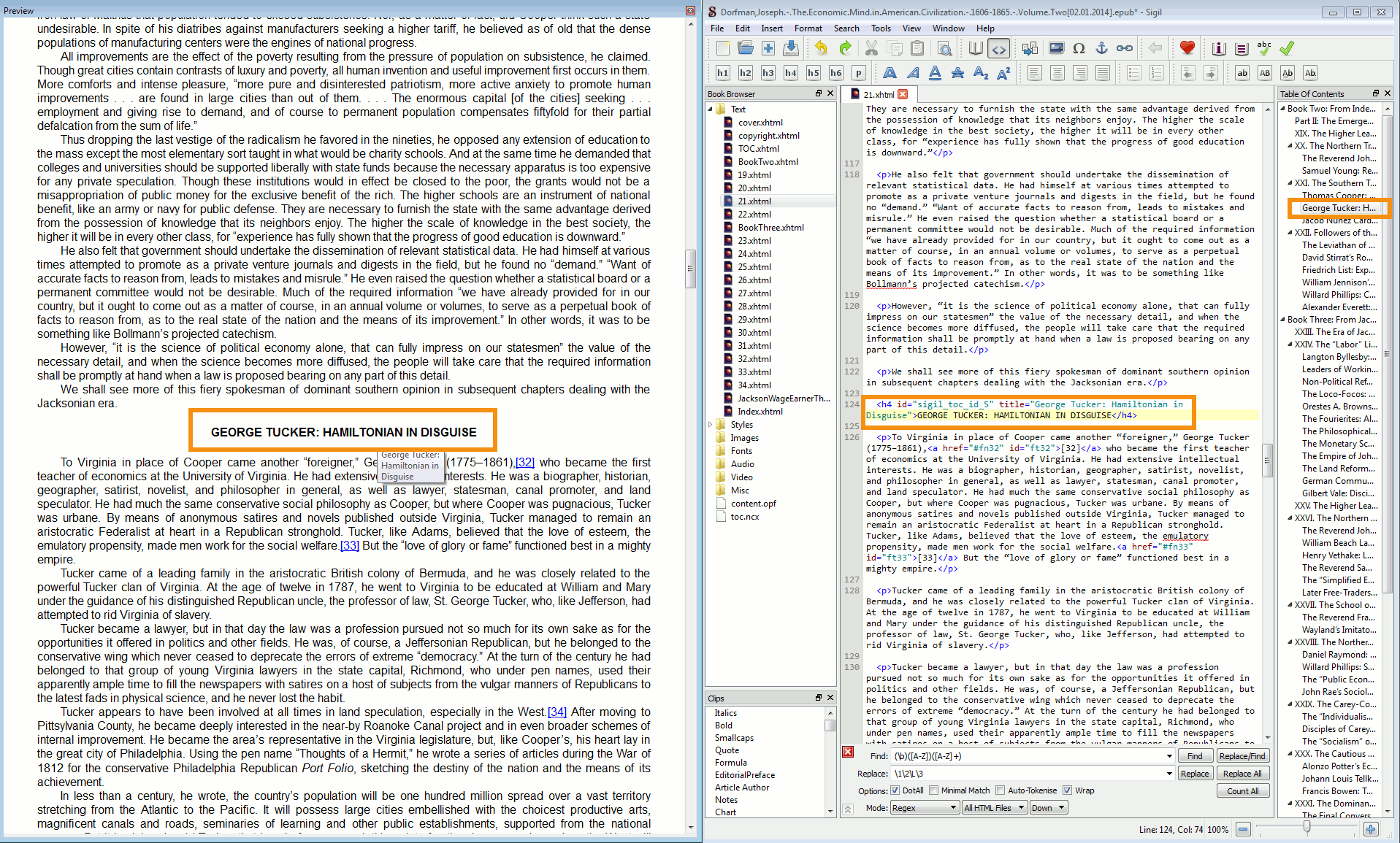

@Tex2002ans -- thanks, I tried something similar, but the document had a lot of all caps acronyms that were being found. I tried the 'Replace/Find Next' but that was taking a lot of time
Ahhh... what I do is run this regex as one of my "final" cleanup passes.
I have a toc.ncx already generated, and/or I have preview open up on the left-half of my screen. I quickly jump to where I need to be using TOC/Preview, and then Find/Replace what I need in Code View.
I don't use this Find/Replace throughout the entire book (unless this particular book has some odd ALL CAPS floating around it that need to be checked/fixed).
It isn't the quickest/most automated way to do it, but while I am fixing this I am also quickly just scanning around/taking a look to see if I can catch any other typos/errors.
