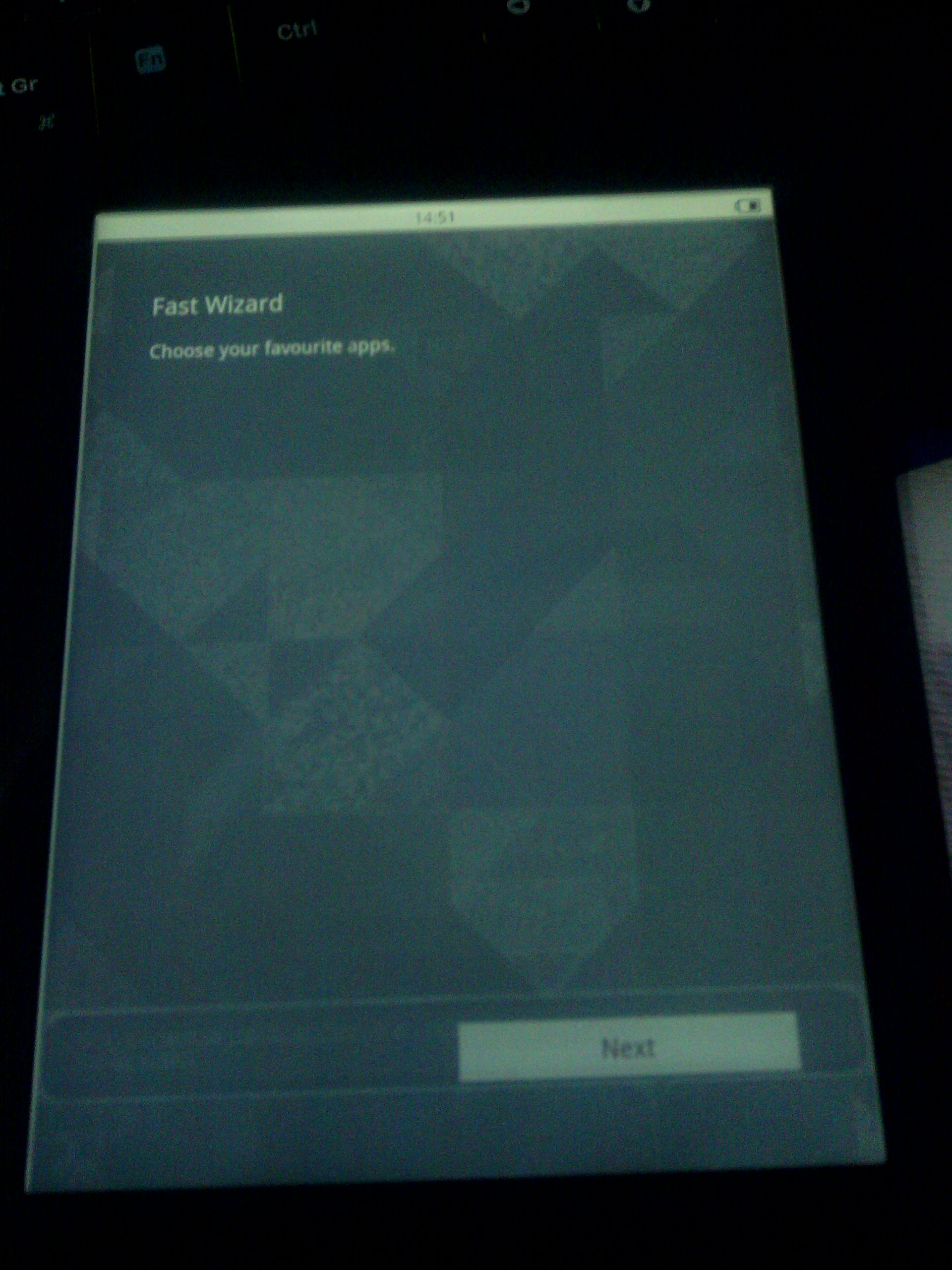

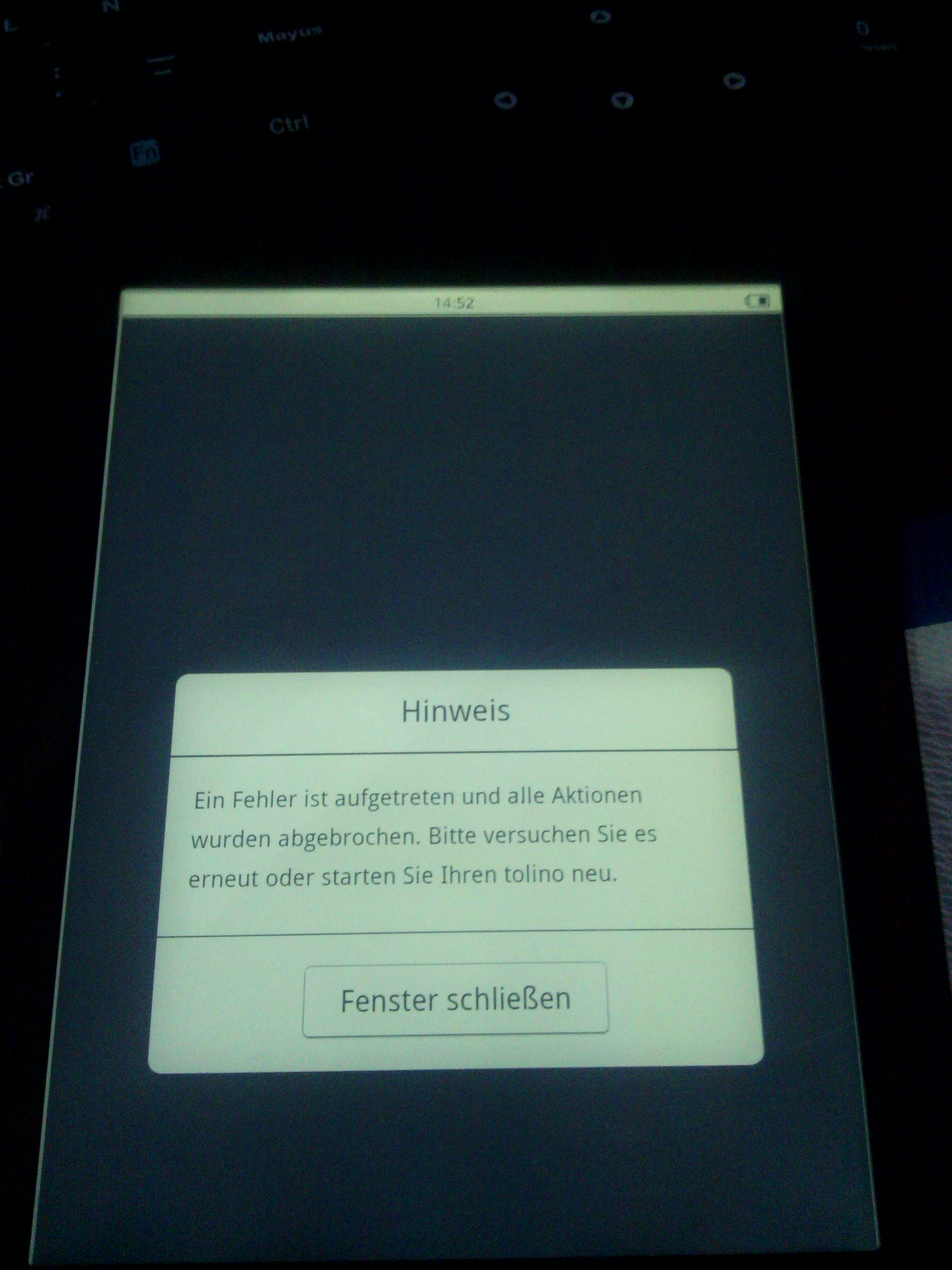

Hi embryo!!
First of all: thank you for all the info concerning porting Android to Kobo.
I've tested, but I get an "error" message everytime I try to run SmartLauncher.
As you can see in the pics I have the option to click "next", but when I do, a pop-up window force me to start the system again. But... no matter how many times I try I can't seem to manage to get rid of this window...
Any clue on what is happening?
Thanks in advance!!!
What Kobo do you have?
I've used only the Glo, and there was never a "Fast Wizard" running.
The first thing I saw when I booted Android for the first time, was the desktop of SmartLauncher, already running.
How did you get to the "Fast Wizard"?
Kobo Aura HD.
The first time, it showed a pop-up window which let me choose starting with Tolino or SmartLauncher... but no matter the option chosen it always crashes.
I'll try to make some pics of those screen steps for you to see...
Strange???
I even could see Tolino running...
Kobo Aura HD.
Hmm..
I thought so.
Because the Touch and the Glo images are almost the same.
Unfortunately I can't help you with AuraHD because I don't own one, but you can try and ask (or PM) phj that made the original image here.

My Kobo Glo works in Android now, thank you for your help.
I cannot use the Kobo rotate apk. After activating it the screen rotates allright but every touch area of the app remains in the position it would be in portrait mode.
Tried a task killer but it didn't work. I got an error message in German and go back to the home page.
I wonder which comic app will rotate the screen OK... Perfect Viewer rotates the screen but the touch points are still in portrait mode so when you get a menu you have to devine where it would be in portrait mode...
