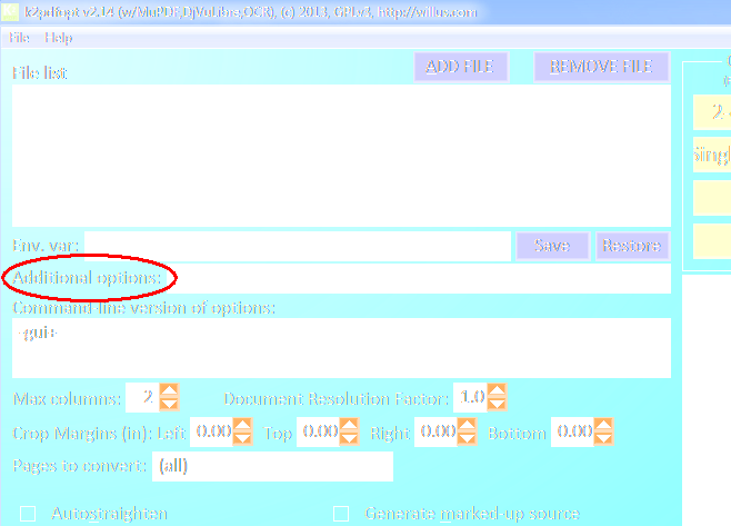

Originally Posted by Sajjad76 View Post
Hi,Thanks for your software.
I have crash problem too.
When I choose 5 options simultaneously
OCR.
Autostraighten.
Erase vertical lines
Reflow text
Fast preview.
Is it normal to have crash?
Another thing,How can I use Command lines where should i type them?
Thanks
Sajjad
@Sajjad76--Please check your private messsages. I would like to get the source PDF from you. Enter extra command-line options into the "Additional Options" box--see attached.
