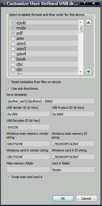

In addition to the Connect to Folder function found under the Connect/Share button, calibre provides a User Defined device plugin that can be used to connect to any USB device that shows up as a disk drive in your operating system.
Note: on windows, the device must have a drive letter for calibre to use it.
Go to Preference ->Plugins ->Device Interface Plugins ->User Defined USB Driver and click the "Customize Plugin" button.
I'm using these values:
USB Vendor ID (in hex): 0x1f85
USB Product ID (in hex): 0x1689
USB Revision ID (in hex): 0x0226
Windows main memory vendor string: DEUTSCHE
Windows main memory ID string: _TELEKOMTOLINO
Windows card A vendor string: DEUTSCHE
Windows card A ID string: _TELEKOMTOLINO
I found them from Preferences -> Miscellaneous -> "Get information to setup the user defined device".
I use the extsd\Books folder for the library root.
Don't forget to check the "Swap main and card A".
Note that if you are using the user defined plugin for a device normally detected by a builtin calibre plugin (Tolino doesn't), you must disable the builtin plugin first, so that your user defined plugin is used instead.
Name:	Calibre User Defined Device.jpg

Ouahh, thank you so much Embryo, that is what I call a detailed tutorial
