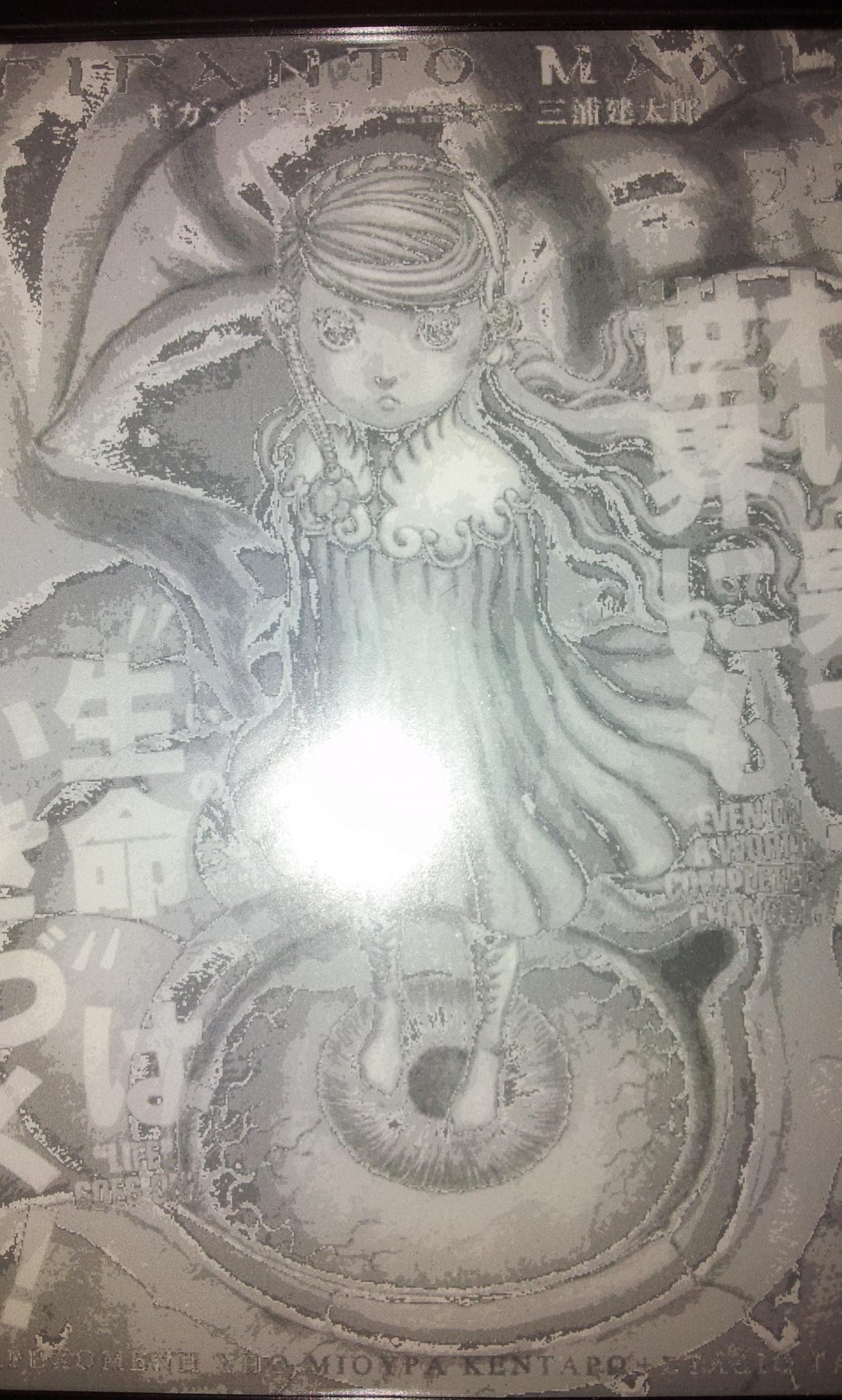

Hello, here is another example of the "gray" bug. The left picture is from build 644 and the right one from 701. I have tried several builds until I found the bug has been occuring since build 656.
That looks right for my experience with my AuraHD as well. I guess there is some different C routine called with the FFI than was used with the straight LuaJIT external calls. In any case I hope they can find some good rendering code to go with the FFI approach.
