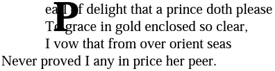

But in ADE the effect is rather gruesome (screenshot attached). There text lines leave some empty space for the drop cap, but the drop cap is placed outside this empty space, over the text. It looks as if the float is not obeying text-indent. A quick test in my reader showed the same behaviour.
I can easily work around it by adding some margin-left (and increasing margin-right), but then it does not work properly in a browser or, I guess, in non-Adobe readers.
Does anyone have some working (in ADE or, at least, Adobe-based readers) code for drop-caps in poetry, or any new ideas?

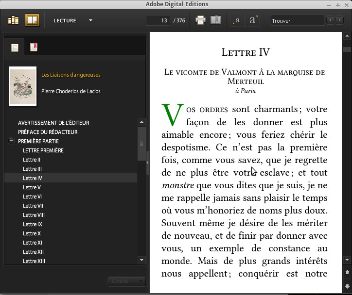

This is what I am using for plain text. I am aware it's a bit complicated ( I have one font for dropcap display and one for small caps) but it works well with ADE and i have been using it for a long time now. I need to differentiate because of the size and shape of some letters.
Using a double span (let1 and let2 or 4) to code the dropcap helps to place it precisely. Hopefully, this latter part of the code could be adapted for poetry.
I insert for example this in the CSS
/*Réglages Lettrines DEUX LIGNES ADE a été privilégié p/r à Sigil.*/
.let1{

<p class="let"><span class="let1"><span class="let2">N</span></span><span class="smcpTypeV">ous croyons</span> devoir prévenir le public, que, malgré le titre de cet ouvrage et ce qu’en dit le rédacteur dans sa préface, nous ne garantissons pas l’authenticité de ce recueil, et que nous avons même de fortes raisons de penser que ce n’est qu’un roman.</p>
It looks like these in ADE (see screenshots)
I also use a regex to put them in place:
S: <p class="let">([A-ZÉÀÔ])
R: <p class="let"><span class="let1"><span class="let2">\1</span></span>
ID:	116963   Click image for larger version
ID:	116964   Click image for larger version

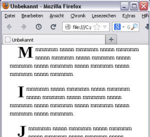

George
ID:	117074   Click image for larger version

Don't know if this what you are hoping however. Anyway, with ADE, the dopcap seems to be correctly placed.
A p inside div.line? I haven't tried that, but I have tried p.line instead of div.line, and it's no difference. Can you share a sample ePub that works in ADE?
but I do want you to know that I understand that the problem is dropcaps AND poetry for the negative-indent you need for the wrapped lines on the stanzas/tercets/whatever.
Thanks, sometimes it's nice to know someone understands

Hi
I am afraid, despite all these crystal clear explanations, Jellby's request is still fuzzy for me and I must apologize for being so dumb. Sometimes a small drawing is worth one thousand words. So, maybe a screenshot of a printed text could make me realize what he is looking for.
After that, maybe, I'll also understand probably why a negative indent is necessary.
