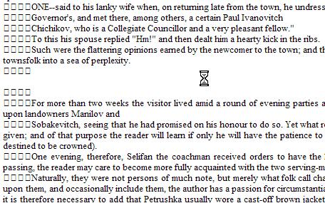

Can't seem to get anywhere with the Bookdesigner help so hoping somebody here knows.
All I want to do is convert a basic lit file to prc.
Not bothered about TOC, pictures or anything clever, just make the thing readable in its most basic format on a Cybook.
Bookdesigner seems the easiest way(though I have previously used clit from the command line), so I opened the lit file in it and saw hard line breaks after every few words. I ticked Reformat Completely in Configuration Settings and got the book changed and it seemed to take out all the hard line breaks.
On the Cybook it reads fine, except for line breaks appearing a few times per page where they shouldn't.
Looked at it again in Bookdesigner, and turned on "show nbsp" (no idea what I was doing, just guessing) and it showed four tiny squares at the front of every rogue line break. But they also appear in front of every proper line break too.
Does anyone know what is going on and how to remove the rogue breaks and leave the normal ones?
A screenshot is attached of the LHS of the screen- the big gap is a chapter break which is OK.

"nbsp" is "nonbreaking space", it seems they are used here for indenting paragraphs, and since every hard linebreak is interpreted as a paragraph, it has added the four spaces at the beggining of each one.

It is not the &nbsp; (non-breaking space) that is causing the problem. They would just show a gap between the words. The problem is the extra CR/LF sequence at the end of each line that is causing the problem. That is what must be removed. Then you can attack the nbsp problem which is easily fixed as you point out.
But if it starts out as a LIT file, the "underlying" format is HTML, and carriage returns are ignored in HTML - paragraphs are defined purely by "<p>" or "<div>" tags.
I would suggest using "ConvertLIT" to "explode" the LIT file to OEB, and then look at the resulting HTML source to see what's causing the line breaks.

Ned, Book Designer has a bug that if you load in a text file the paragraphs can become messed up. So if you have a text file you are trying to load in, first load it into Word and then save it as RTF and then load it. The Paragraphs will come out fine. Also if you have to do any editing that involve the line endings, Word will let you and then after you've edited it and saved as RTF, you can load into Book Designer without having your paragraphs messed up.

From personal experience, a lot of .txt to .html conversions for inclusion in a .lit file have this problem. So we have Garbage In-GarbageOut and reconversions become problematic!
Basically, the original CR/LF line endings in the .txt file were mindlessly just converted to <br>, and thus any attempt to salvage this situation using the exploded .html from a .lit should address this issue.
In a text editior, open the .html and search and replace all: <br>\n with a "space" or just nothing
[i.e. search for <br> followed by a newline character and replace with a space or nothing (whichever works better). Note: sometimes the newline may not exist, so search without it, in those cases]
