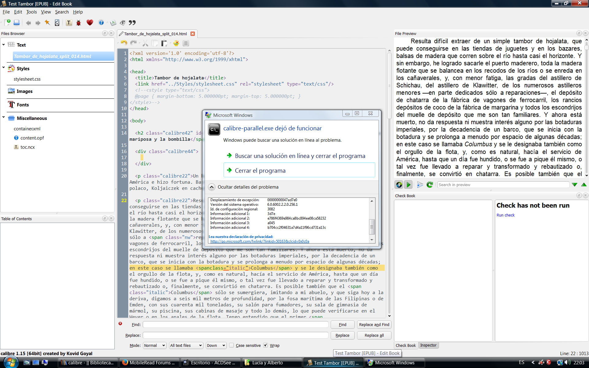

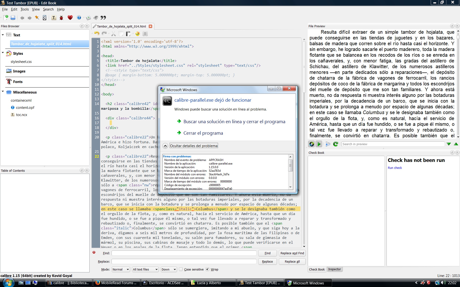

Hi, I think I've found a bug in Edit Book.
When I edit nearly any tag in the book I'm currently reading and I make a mistake (as example from <span class="italic"> to <spanclass="italic"> in line 22), I automatically get the error shown in the screenshots. After this error, Preview is no longer updated.
But this issue doesn't happen in other books where I perform this same mistake.
(I've even built a test book with just one chapter of the original one and its associated stylesheet, where the issue is still present. If you want I can send it to you in the way you want)

@arspr: That comes from having an not upto date version of lxml in the build. Which version of calibre are you using? 32bit or 64bit and on whichi OS? EDIT: Never mind, I see its 64bit windows. I will update lxml in that build, which should fix the issue.
