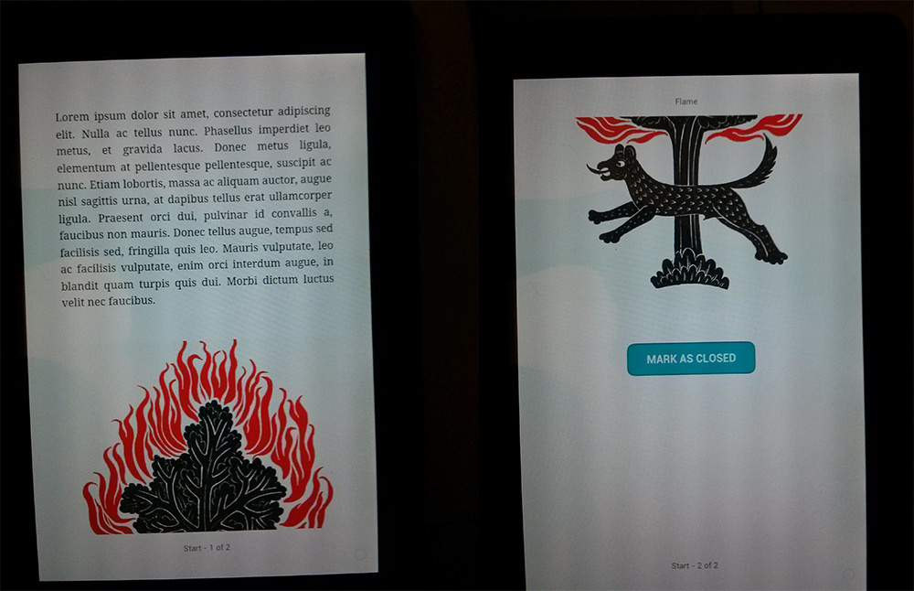

Thanks Rubén but not in Kobo
neither in landscape mode...

Well, let's continue trying
Do the following:
Open the ePub that I uploaded in my previous post with Sigil and, in the stylesheet.css file write:
.TableCell {
  display: table-cell;
Now, enable the Section0001.xhtml file and in the Code View, where you see:
<div>
    <svg xmlns="http://www.w3.org/2000/svg" height="100%" preserveAspectRatio="xMidYMid meet" version="1.1" viewBox="0 0 1153 1577" width="100%" xmlns:xlink="http://www.w3.org/1999/xlink">
      <image class="TableCell" height="1577" width="1153" xlink:href="../Images/flame.jpeg"></image>
    </svg>
</div>
write:
<div class="TableCell">
    </svg>
</div>
Save all and watch how does it look in Kobo. If doesn't work, then try:
<div>
    </svg>
</div>
Maybe this time we are in luck

What are you actually using to view this? I assumed a Kobo e-ink device, but, I just noticed that the photos showed colour on the screen. Are you using a Vox, an Arc or the Kobo app on an Android or iOS device?
And for the record, attached are screenshots taken on a Kobo Glo with the latest firmware. This is with RbnJrg epub. "flame_epub.png" is of the epub which uses the Adobe based reader. "flame_kepub.png" is loaded as a kepub which uses the ACCESS based reader.

I'm testing it on Kobo Arc.
Rubén, with your first solution there is only one page and the image is missing in a mysterious way...the second one does the same.
Is there any way to disable the landscape mode only on Kobo?
