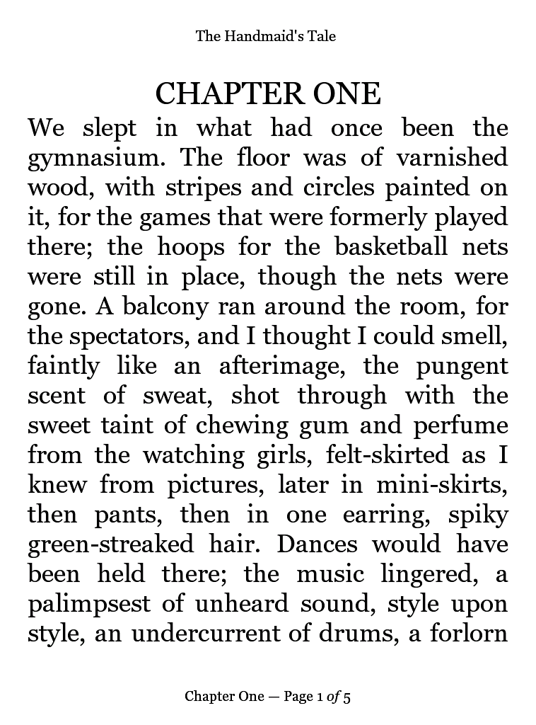

No I don't use kepub-book.css, but the symptoms are similar to what might happen if there was a file like that stomping on the stylesheet.
The font size problem seems to be just one book, but the missing vertical margin affects a lot of my kepubs.
Attached is a screenshot of a typical one. The chapter heading is h2 {margin-bottom: 2em}, the first line of text is p {margin-top: 0}. It displayed correctly in earlier firmware, but with 3.1.0 it looks like the h2 margin has been lost.
Edit: this book is http://store.kobobooks.com/en-nz/ebo...dmaid-s-tale-1 I wonder if the problem would show in a preview?

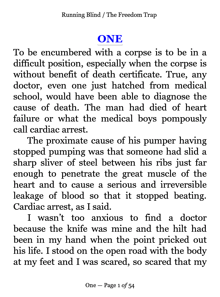

Here is a comparison of the preview of this book http://store.kobobooks.com/en-nz/ebo...e-freedom-trap on the Mini with firmware 2.6.2 and the Glo with firmware 3.1.0.
The spacing difference is obvious, but the size of the chapter heading is different too. On the Mini the chapter heading is 38% taller than the first letter of the text, but on the Glo it is only 14% taller.
Edit: On second thought, the difference in font size might not be significant, the heading is probably supposed to be 125% of the text size (large vs. medium), but selecting the closest font size in pixels might just have resulted in rounding up on the Mini and down on the Glo.
I downloaded the sample and there was enough to see what you mean. I had a look at the book I was reading, and I'll take back what I said before. It looks perfect, but there is no spacing around the headings. I checked it against the epub version which does have spacing. And I remembered comparing them when I started the book as I was wanted to check the formatting. I also looked at it in the Kobo app on my shiny new iPad, and it shows the spacing there.
