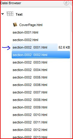

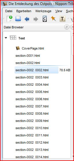

Kovid, I detect one small problem in the file viewer left-hand: If I had selected a file and then jump to an other one with mouse right click, this new selected file will be deleted immediately instead of showing me the possible file operations. Guess, this is wrong.

@ Kovid. Maybe, this is a problem in Windows? I am using Vista64bit. I made a screen shot. First one show what I try to select and second show, the file is gone but I can make a redo of the action.
Edit:
I made just a test in Ubuntu 64bit. Same situation (Calibre 1.14.0). I am missing the pop-up

It is exactly the same way as you did in your post #201. But after point 2 (right click) the file selection-0002 0001 will be deleted w/o any pop-up.
The way:
1. selecting selection-0002 0002.html
2. selecting with mouse right click selection-0002 0001.html
3. selection-0002 0001.html is deleted w/o any pop-up and I can a redo with the left arrow icon in the menue to recover the file back.
Edit:
It seems, that the first menu item is active by first click (delete selected file). Only with the first click, after that I become the context menue for selection
