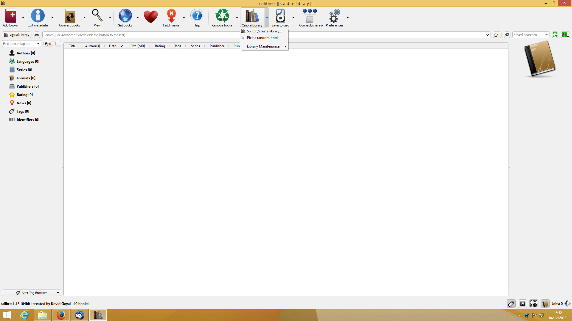

Confirm I have Calibre 1.13 64 bit.
Drive "D" is an internal hard drive ( the re-write DVD drive is "Q" for me "
I presume you mean the main icon "Calibre Library " the drop down list has only 3 options " Switch/Create" ; Pick a random Book ; Library maintainance , or am I looking at wrong main icon ?
When I select the "Switch/Create" option, the top line in the box, above the 3 buttons says " Your current library is located at D:\Calibre Library" , but no books are shown on the main Calibre interface.
If I select the 3rd button "Move current library to a new location" , then specify "D:\Calibre Library" ...>OK .........It says "Your current Calibre Library is stored at this location" !!!!!
I have tried the 3rd button again, however moving it to a new folder at C:\Users\DFC\Documents\Calibre Library. The move seemed OK, however the only files that moved were the 2 small database files, leaving the books in D:\Calibre Library .
I have also tried uninstalling/re-installing Calibre, running through the Welcome Wizard, the only stage I skipped was the EMail screen, but same results as above.
What am I doing wrong ?
It seems my library is there but Calibre is not able to read it

It sounds as if the library location on the D: drive does not have the metadata.db file from the library that you copied, but a new empty one. That could happen if you told Calibre to create a new library there rather than use an existing one. As Calibre will only display books that are entered into the database that might explain your symptoms.

What is the location of the library on your old XP system ?
I can't understand why it should not have "Calibre Library" in the list under the separator, yet display "Your current library is located at D:\Calibre Library" in the Switch/Create dialogue.
Did you browse to the "D:\Calibre Library" location via the blue button or did you type the path - I suggest you use the browse button to select the folder
Another thing you might try is to browse to the copy of the library you have on that USB drive - I have to go now, hopefully others can help you get this resolved.
Good thinking itimpi - my suggestion to browse to the folder on the USB drive should confirm that

The OP posted
So something like this
But if D: is a DVD drive on the new Win8.1 system what would calibre do if I entered "D:\ Calibre Library"
Maybe it would display something like
That's what it does here
Dark Ale
I'm in Sydney, not Newcastle UK - I don't think we have Dark Ale -- you'll have to settle for Fosters lager or a Coopers cloudy bitter.
I would expect a DVD drive would cause a lot more errors (messages too) than just a Blank Library.
I don't know about W8, But I have additional internal drives D: E: on one system and I reassigned (forced) the letters for the CD-burner and DVD to F: and G: using the disk management tool

Something is really hinkey
1) is there a metadata.db in the indicated folder
2)What are the user rights for that folder (and all child folders)? They need to have 'FULL' (read/write/delete/create)
Regardless of what the top line says. Use the first item to browse to the Library.
Maybe W8 does not like full rights to a Root folder
On one of my systems (xp) d:\users\Calibre Library
Just keep the first level name short

'Indicated' at the top of Create/switch dialog
If you are seeing any Library grid (even empty), there IS a metadate DB (just a small one). Search your system for more than one
Separator (See image)
There might not be a separator if there is only ONE library defined
Below the line is the 'Quick Switch' list

"theducks" :
Indicated library ............yes , there was a library indicated, although nothing displayed where my library of books used to reside.
This is what I get when I selct Calibre LibraryClick image for larger version

quit Calibre (no content server running either)
copy the folder (not just the contents) H:\Calibre Library From the Thumb drive
COPY THAT TO d:\ (this will replace the current one. The answer is Replace All if when asked)
When completed:
Now start Calibre You should see books
As an additional check (highly recommended when changing OS versions)
Run both parts the Library Maintenance. resolve any issues
