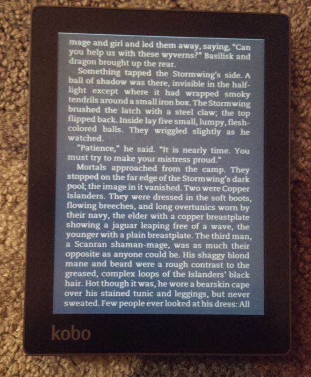

You could try running cool reader by installing kobolauncher. Cool reader has the ability to inverse the screen
I tried version 1.2.6.23 out on the Aura (non-hd) and it works great. and does let me finally invert on the Aura! I will admit the menus are not amazing but get the job done. Swiping doesn't seem to work and the footer doesn't have options in the list (unlike the header) but I prefer nothing in the margins. I can't seem to find a way to figure out where you are at percentage wise though without turning on the header or bookmarking and then looking at the bookmarks. Any suggestions? I know I'm picky. I will post this in the kobolauncher post as well: https://www.mobileread.com/forums/sho...d.php?t=201632
But will leave this post here for people reading this forum looking for a solution to inverting their Aura screen.
