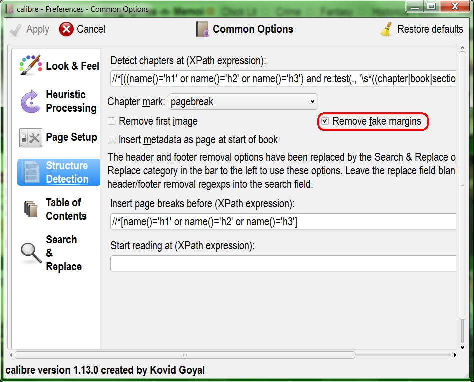

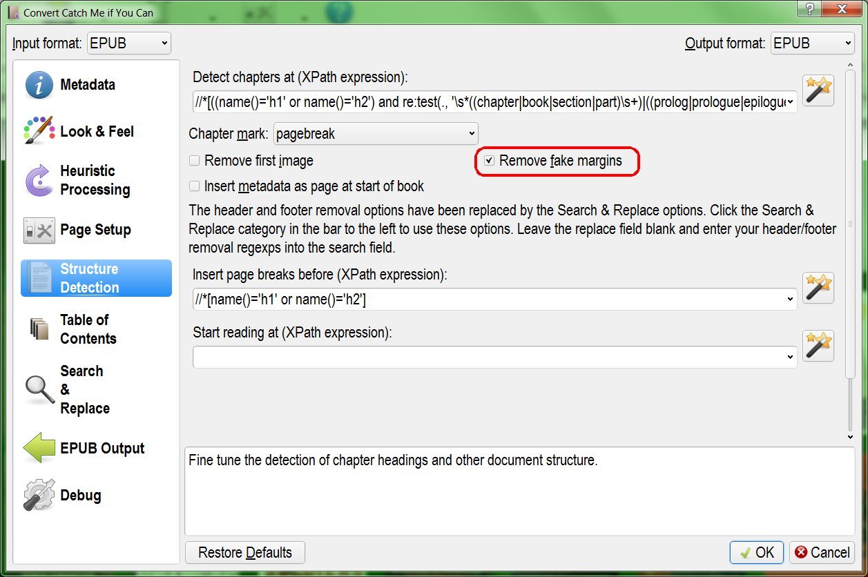

During conversion Calibre reported removing of "fake margins" - that were all my added negative margins.
If you don't want fake margins removed then uncheck the box, see attached. Image one is the per book setting that is saved if the book has been previously converted and image two is the Common Options, set for all future book conversions.
ID:	115957   Click image for larger version
