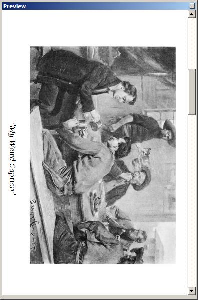

Errrrr, yeah. I know I said I wouldn't be messing with rotation, but it is a woman's right to change her mind, isn't it?
I would like to run some captions along the *left* edge of the page, and by looking at one of SBT's books in the MR library, I got the caption placement and rotation kind of figured out. But I'm not so sure if my twiddles on the image placement is the correct way to do this (it was all by trial and error, you see).
<div>
<svg xmlns="http://www.w3.org/2000/svg" height="100%" preserveAspectRatio="xMidYMid meet" version="1.1" viewBox="-75 0 600 720" width="100%" xmlns:xlink="http://www.w3.org/1999/xlink">
<image height="720" width="500" xlink:href="../Images/001.jpg"/>
 <g transform="translate(-50 360) rotate(90 0 0)">
<text style="font-style:italic;font-size:20pt" x="-80pt">"My Weird Caption"</text></g>
 </svg>
</div>
So are the negative coordinates really the correct way to do this, or did I just stumble on something that happened to work out?

It works in the Sony Reader Library, right or not. I suspect you can not scale it because you have to set a viewbox of a given size, but it is still a good step forward.

I've viewed this in the Sony software (Sony is very sluggish on every pc I try it on, takes 3 - 5 seconds just for a page turn!), with ADE, and Calibre, and the images seem to scale ok when the window is resized. I am going to push ahead on the assumption that this code will work.

"Natural" meaning in the way they were layed out in the print book, or natural as in the horizon is always horizontal?
edit to add PS: I still have not found any info to confirm if using negative coordinates to position the image in the SVG wrapper is legitimate code. Anybody?
The latter, the way they are intended to be viewed.
I would be surprised if it wasn't.

@Jellby, thanks for confirming. And big thanks for your patience, I'm slow on the uptake these days...
