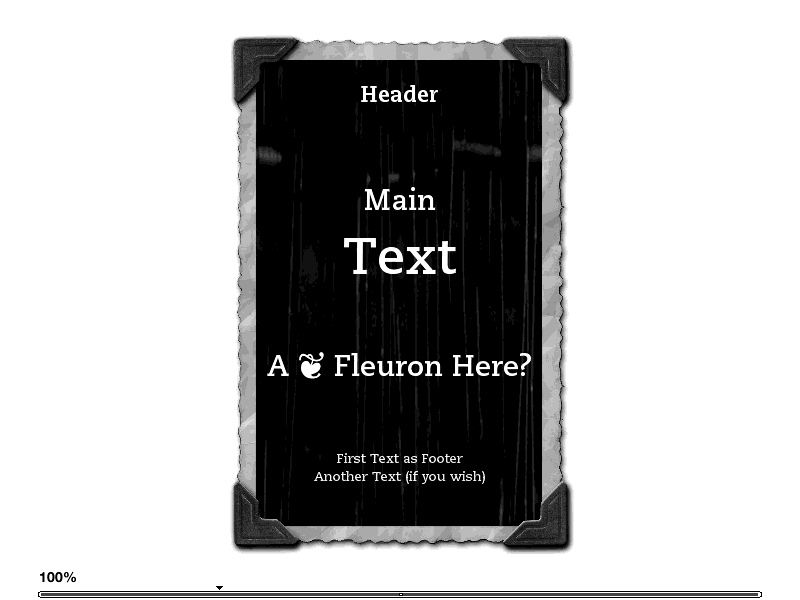

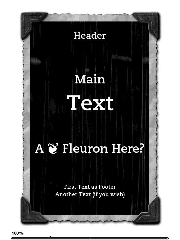

Ah, ah, ah. We have a problem here You can have a background image with text over it but troubles appear when you want all the text stay within the background image. We have a problem because ADE doesn't support the properties to achieve that. See this post:
https://www.mobileread.com/forums/sho...43&postcount=4
As you can see, the text remain in same page, no matter if the device is in portrait or landscape mode. But that technique only works for Kindle and iPad; you can't get that output in ADE and on ereaders based on ADE So is as it looks in my K4NT:
Portraid mode:
Landscape mode:
Below you can see the respective ePub.
But if you want all the text stay within the background image no matter the device and the device's orientation, then the easiest thing is to write the text directly over the background image, as Alex made. The alternative is to use svg.
