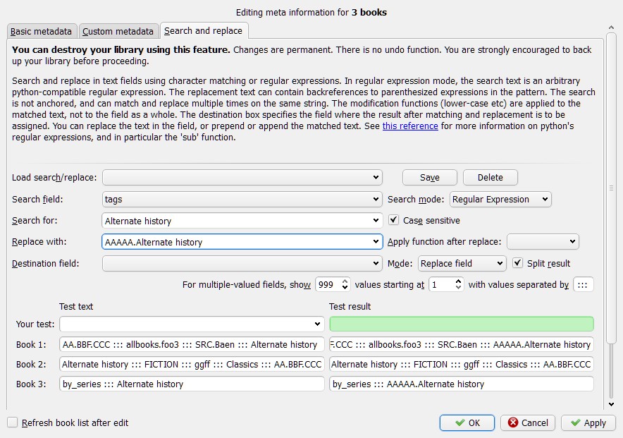

Option 1: Right-click on the tag in the tag browser and choose "Rename".
Option 2: use bulk edit search replace as shown in the following screen shot.

You can edit the tag itself in the tag navigation (right-click/rename on a tag), or from the tag editor (open an "edit metadata" window, click on the icon on the left of the "tags" field). The change will be made across all books.
Also, if you rename for exemple "Fiction - SciFi" to "Fiction.Scifi", the "Fiction" tag will be created along with "Scifi", and every book tagged "Fiction - SciFi" will reflect the change.
(I think it's because "Fiction.Scifi" is not really two separate tags, it's just the tag navigator making it look like the latter is the child of the former. But from a database and book POV, it's really just one tag named "Fiction.Scifi")
