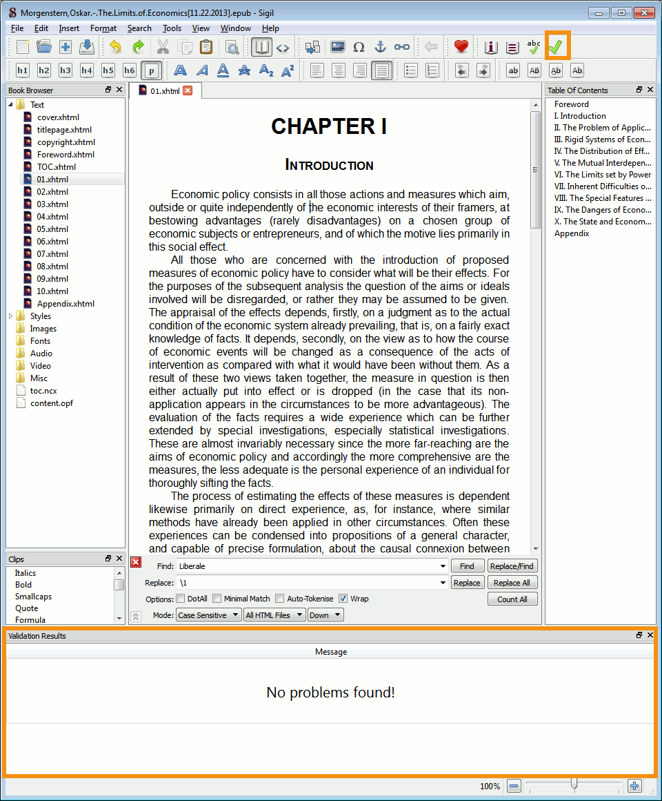

If you open the EPUB in Sigil, and click on the checkmark in the corner, it might also give you a slightly more "understandable/helpful" error:
