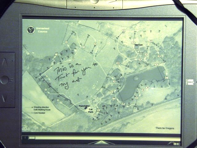

The scribble is just a handwritten script that says "This is a test". Of course I forgot you can't read the scribble on the pdf.
Here's the photo

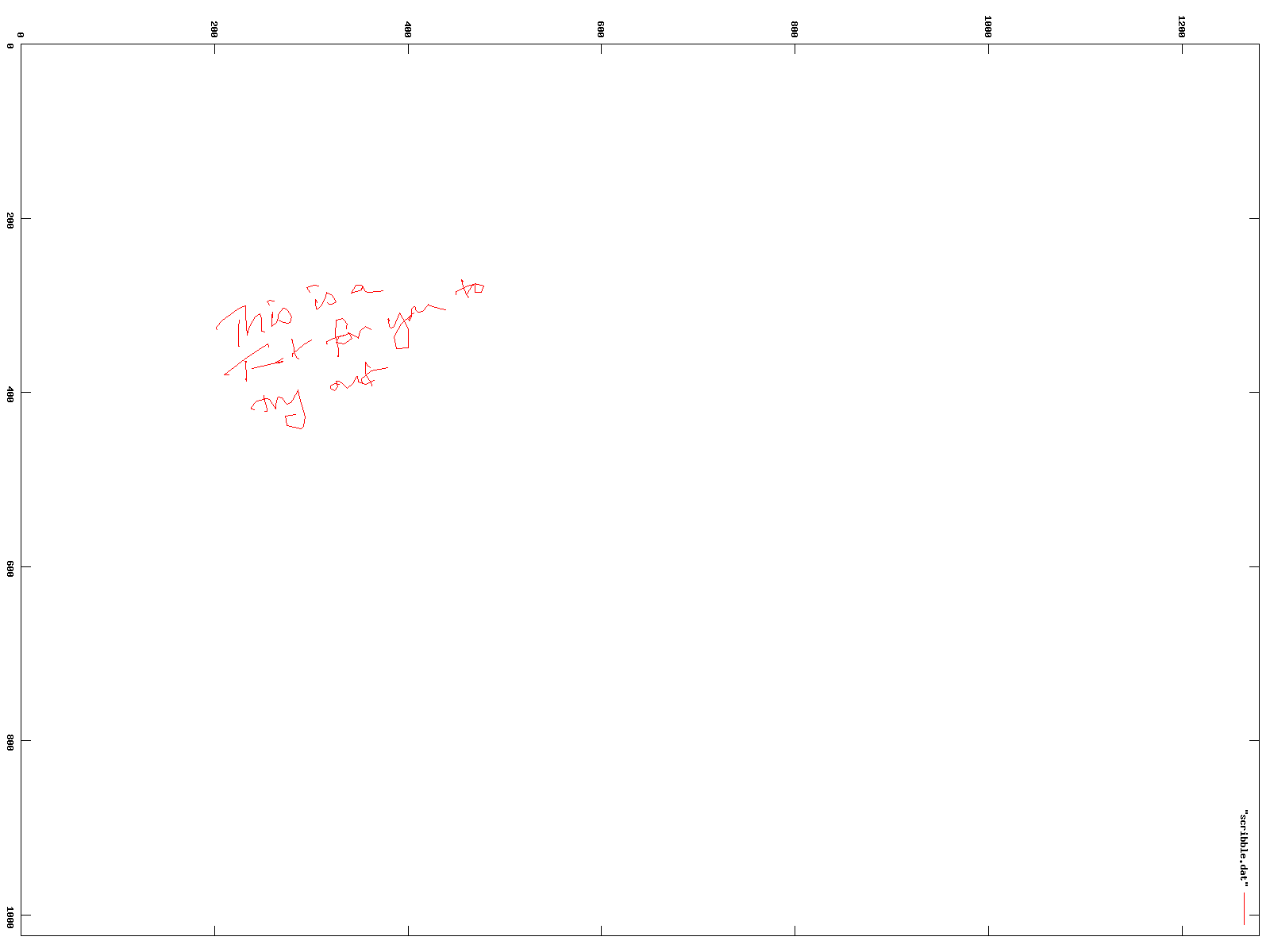

And here's the decoded scribble: Click image for larger version
ID:	17000This is of course still very far from a usable program, because I need to figure out how zoom, rotation etc. are encoded. Also I need to reaquaint myself with java if I want to use the iText library.

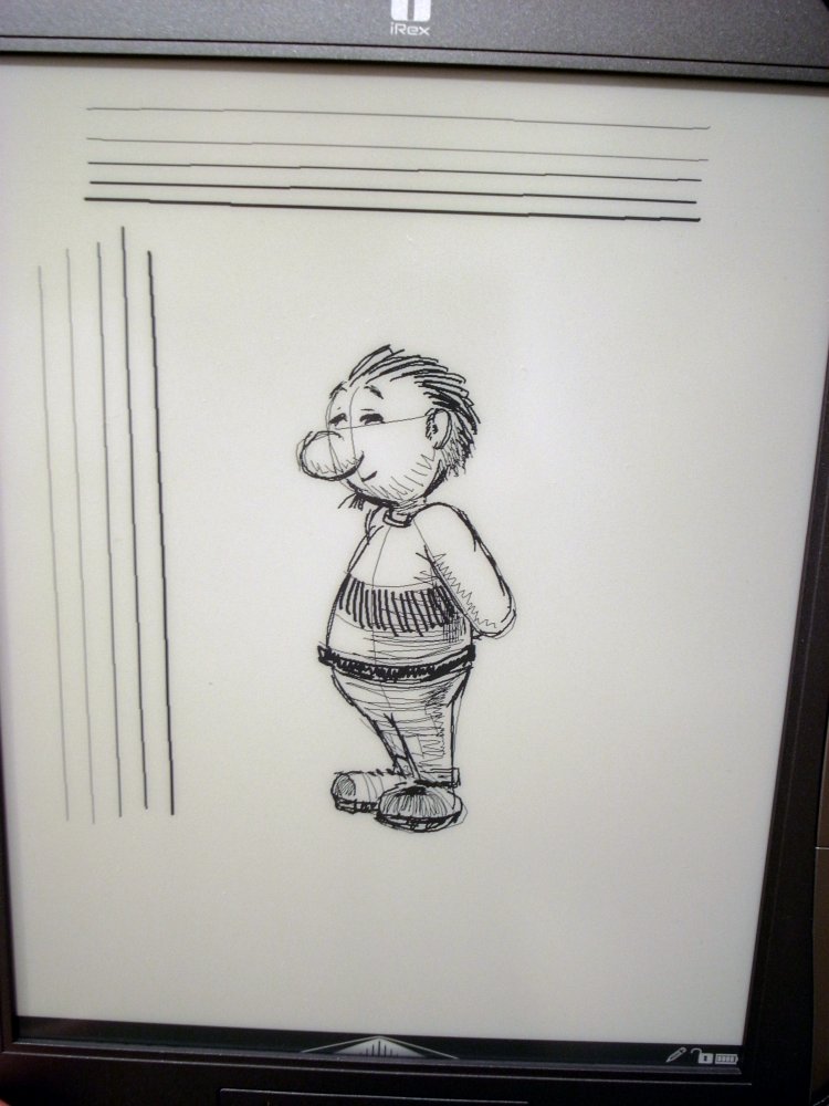

I have included a picture of a sketch I made, and the resulting "merged" PDF from the iRex PC application... judge for yourself. Anybody had better luck?
I have also included a zipped folder with the default MeetingNotes.pdf, the 1024x1280 Blankpage.pdf I made and properly "templated" (the one thing that actually works in the PC app) and BlankPage 001.pdf, which contains 5 more or less vertical and 5 horizontal lines, one each for every pen size. (plus the corresponding metadata.db) Maybe that will still help in the decoding. I deleted the .db file just prior to doing the test, so this one should be spot on.

Upon further investigation:
- The Merge only works for PDF files for now, not images. The reader supports it, even templating, but not the PC Companion.
- The resulting merged PDF seems to have a scaling issue, which may explain the thick lines. The PDF is way too big in any other PDF viewer (the scribble too small relatively speaking) BUT back on the reader it looks the right size (except for the super thick line)
It seems the scribble is stored as coordinates on the metadata.db, and the PC companion replaces every straight line with a black rectangle of the same length but a fixed width, then layers that on top inside the PDF file (which may explain why that is not possible with image files which do not normally support layers (or vectors))

The scribble is a list of strokes and each stroke is a list of points. If I interpret the coordinates of each point as pixels on a 1024x1280 screen and connect them by straight lines, I get a good approximation for the two examples that I have seen so far.
From your example (thanks!), I could figure out where the width of each stroke is stored. The unit is probably again device pixels.
That's no excuse: the software could always draw on a bitmap of the image (cf. The Gimp, ImageMagick or Photoshop). It's not completely trivial to make joints and diagonal strokes look nice, but it's not rocket science either.
There are some more bytes that I could not interpret yet (one of them must be the color and there should also be zoom, offset and rotation information, but there's more). I would have to purchase a reader in order to experiment with the settings to decode more of them. Unfortunately, the german distributor is currently sold out.
