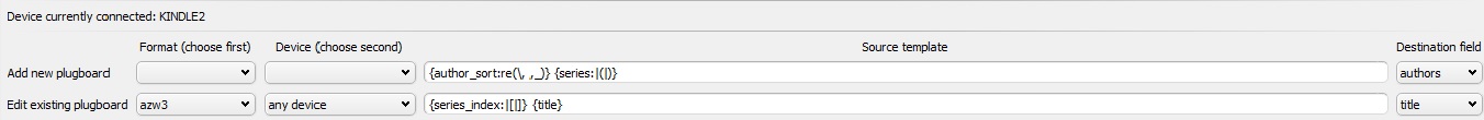

Hi, I was wondering if anyone would have some suggestions for me. I am new plugboards column management. I have been reading and trying various different ideas others have posted, but haven't found exactly what I am looking for.
Firstly, I have a large book database and so I am looking for something that will be a little less time consuming then editing individual entries.
I am currently using calibre 1.11 64bit using the kindle collections plugin on a jailbroken Kindle PW1 with K5 collection manager.
What I would like to do it to ultimately have my books sent to and displayed on my PW1 in the format:
[1] A Game of Thrones - A Song of Ice and Fire
George R. R. Martin
Now I have achieved this using metadata plugboard entry post from another member (see attachment "metadata plugboard").
This method requires me to modify the "title" of each of my entries and copy from the series field in calibre and paste it into the title field in order to show the series information on my PW1
"A Game of Thrones - A Song of Ice and Fire [01]
at which point I then need to remove the "[1]" because if a title is too long it gets cut off, and in the metadata plugboard it puts it in front. SO can always see which book number it is on my PW1.
This method also doesn't create collections on my PW1 for organization purposes on my PW1. I would like collections to ultimately created in this format using the above example:
Martin, George R.R - A Song of Fire and Ice (and then I can use the k5 collection manager to tag the various books in that series)
I have tried time and time again to use some form of custom column using the "columns built from other columns, behaves like tags which would make use of the calibre kindle collection plugin which would eliminate the need to modify the title field with the series in it but for some reason it doesn't work out that way once it is sent to my PW1 and I implement the k5 collection manager to create collections.. it creates several collections under author, under series, and under title.
I used the {author_sort} - {series}{series_index:| - | - }{title} as template entry.
If anyone can help me with this I would greatly appreciate it.
Thanks and sorry for the long winded post. Just trying to give all the information I can first off.

Why is your custom column of type "columns built from other columns, behaves like tags" when it should be "columns built from other columns"?
Also, use the template
{author_sort}{series:| - |}
so if there is no series, you don't end up with "{author_sort} - " and if you want "Martin, George R.R - A Song of Fire and Ice" then don't use
at the end.
If you use
you will end up with a collection called "Martin, George R.R - A Song of Fire and Ice - 1 - A Game of Thrones" and so forth, a separate collection for each and every book.
I was using "columns built from other columns, behaves like tags" based on another persons post. I had originally tried it using columns built from other columns but had the same results. I thought that since on the PW1 collections are basically just tags I would see if it worked.
If you use
That makes sense. It works perfectly.

Hi Plugboard Experts:
I am hoping you could help me modify my plugboard so that I can get information that will display fully on my kindle. I currently have the following plugboard:
{tags} - #purchased1 - {#stripped_series:lookup(.\s,#initials,.,#shortene d,series)}{series_index:0>2s| [|] } - {title}
I would like to keep the following plugboard except I would like to be able to set it up so that only the first three letters of the custom column #purchased1 displays. I tried to follow the setup for the stripped series but I am completely lost and I think I've messed something else. Can someone help me set up the shortened #purchased1 column??

The formatting syntax ".3" will only use the first three characters. You can always use the function shorten but I doubt you want to, this is so much simpler if all you want is to just use the first x characters.
Using your plugboard, that gets you:
{tags} - {#purchased1:.3} - {#stripped_series:lookup(.\s,#initials,.,#shortene d,series)}{series_index:0>2s| [|] } - {title}
I took the liberty of changing the text "#purchased1" to the field "#purchased1".
If {#purchased1} is sometimes empty, you may want to use this:
{tags} - {#purchased1:.3|| - }{#stripped_series:lookup(.\s,#initials,.,#shorten ed,series)}{series_index:0>2s| [|] } - {title}
to remove the extra " - " that would show up if {#purchased1} is empty.
