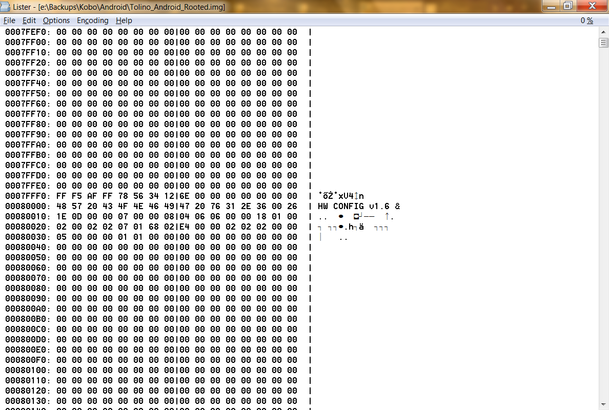

Originally Posted by giorgio130 View Post
Off to try "02" on an AuraHD...
Edit: checking the source that probably should be a "03", no luck though. Just to be sure: the address in the image would be 0x8001e right?
No. It's not the one. About 16 bytes further. 0x8002F? I don't know exactly because I have "00" there now But please compare my image with yours.

I don't see the "03" value supported in Tolino's kernel source code.
It's like:
if(1==gptHWCFG->m_val.bDisplayResolution) {
// 1024x758
else
Is it working on Aura HD but with wrong resolution? If yes, it is possible to fix it by merging video driver code from Aura HD's kernel.
