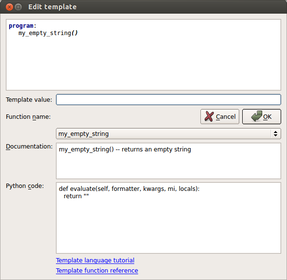

What about this? Experimenting on a spare custom column...
A very simple custom function (I'm not quite up to the big stuff yet)
