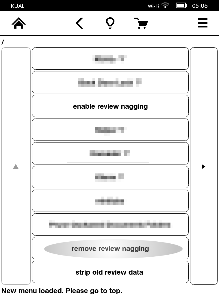

Okay. so update:
Actually, I finished another book last night and DIDN'T get the popup. Which leads me to believe that maybe it does work but only for titles that have never previously "made it to the end", so I will look to implement a blend of both Ixtab's and eschwartz's work at some point RSN.

Post
sorry this took a while, been tied up.
