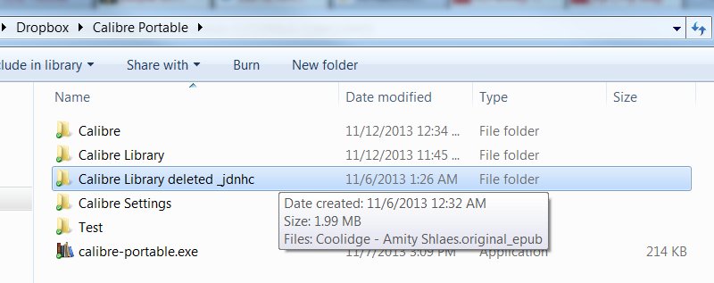

I noticed this during the last week using calibre portable version 1.9. See attached. Inside this directory is the one book shown in the pop-up dialog.
I don't know what the circumstances around it's creation were, but if this is a part of sending books to the recycle bin then maybe Dropbox prevented the deletion of this folder after it was created due to a temporary conflict.

Oh cool, this is actually a bug I reported here: https://bugs.launchpad.net/calibre/+bug/1240797
Originally Posted by kovidgoyal@launchpad.net
For some reason, your OS is raising permission denied (EPERM) errors
when calibre tries to delete a non-empty directory, instead of
ENOTEMPTY, which is causing the problem. Do you have your calibre
library on some kind of special filesystem?
In any case, I have changed the code to not rely on the OS sending the
proper error code, it will now manually check if the directory is empty.
That should fix your problem.
It was fixed in calibre 1.7

I had some of these folders and I was able to create them at will, for me the following changes resolved the problems - I don't use Dropbox or anything similar.
Originally Posted by Version 1.7
Make deleting books to recycle bin more robust. Ensure that the temporary directory created during the move to recycle bin process is not left behind in case of errors.
Originally Posted by Version 1.8
When bulk deleting formats, use a single temporary directory for the deleted files. This makes restoring them from the recycle bin a little cleaner. Also might fix the reported issue with the windows recycle bin choking on creating a large number of folders.
Thanks for the info. I updated my post minutes before you posted. I was using version 1.9 not version 1.5 last week when the orphaned directory appeared. I had version 1.6 on the brain from answering a previous post and had a mild brain fart.
I'm not expecting any feedback from Kovid on this I was just clarifying the OPs position statement for Kovid. If it happens again I'll save the error, but until then I am treating it as a one-off error that I see from time to time because I run Dropbox.
It has appeared again in 1.10, I'm afraid.
Old 11-13-2013, 10:16 AM   #12
Posts: 46,505
Karma: 29634066
The only ways I know of in the current calibre release for the "deleted" temporary folder to be left behind after you quit calibre is if you quit while that folder was being moved to the recycle bin, and if you do so, calibre pops up a message warning you about it.
Or of course, if something like dropbox blocks calibre from moving the files to the recycle bin. However that should only happen on windows, not linux.
RU sure the 'deleted' folder was created after you installed 1.10 - e.g. is its create timestamp after the modify timestamp on the calibre install folder.
Totally sure. I'm using Windows, as Kovid says, so I suppose it's dropbox.
