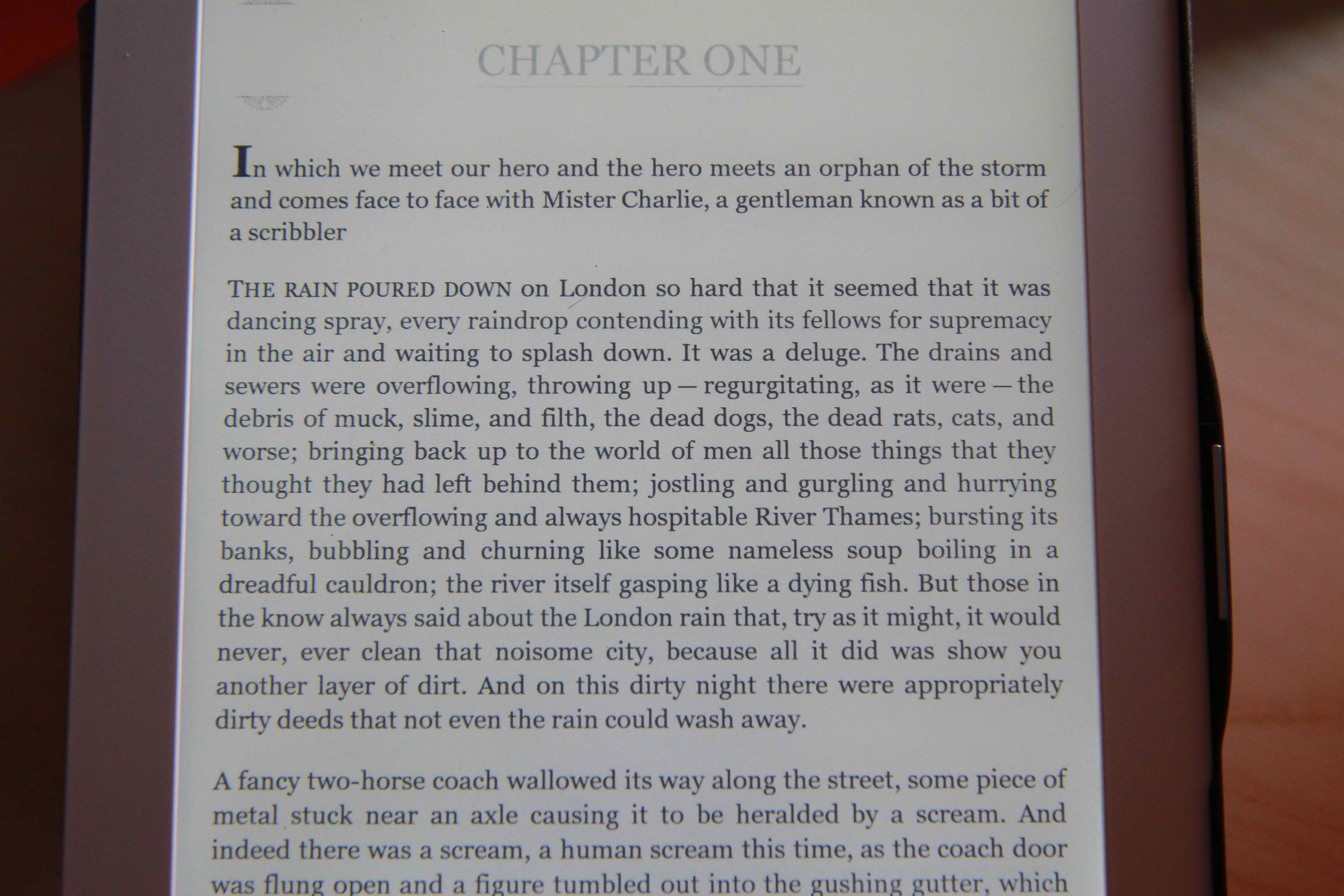

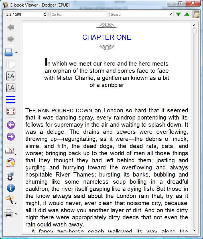

Well, it seems that the dash bug within kepubs is still present. It has nothing to do with jgoguen's Calibre plugin.
OTOH I am pretty stupid myself.
In my original bug post I said that I couldn't confirm it with "official" kepubs because all of them where in English... But they also use dashes, don't they?
So I upload a picture taken from Dodger by Terry Pratchett in two flavours:
  • Fully DRMed official Kepub directly from my Kobo account.
  • Downloaded with ADE, unDRMed and then opened in Calibre. (Although Calibre, Sigil and Kobo RMSDK rendering is just the same).
And I think I can see the problem here. In English, dashes are used as a "comment separator". As stated in wikipedia, (go to the first "dot"), you normally write them without spaces. BUT there's no harm in adding spaces around them and, more over, when you are "stretching" a text in order to justify it, it can be even prettier than keeping the words together. I mean, I actually DO prefer the Kobo screenshot appearance than Calibre one.
But what actually works in English is an extremely bad decision in Spanish where dashes are commonly used for dialogues (although we sometimes use them as comment separators, we normally prefer brackets).

OTOH, I'm now on 2.10.0 firmware and my eReader is an AuraHD, not an Aura. (Although as I said both data seem quite irrelevant).
Originally Posted by arspr View Post
As proved, do not bet money along me in a horse race...
Well, in the end, I'm not going to be so bad gambler...
OTOH. Don't you see something strange in the screenshots? Look at the drawing below (and over) the "CHAPTER ONE" text. Why isn't it centered in the kepub one? Another bug in ACCESS? Or just a bug inside the Kepub version of the book that Kobo stores?
(I've tested with Off-Left-Justify. It's always the same).
Curiously, in Off the book is left aligned in the "official" kepub version. BUT the downloaded epub through ADE is already justified...
I don't know a way to check it, as I don't know how to break Kobo DRM scheme on their official kepubs so I cannot open it up.

Speaking of which, try adding "showPageHeader=false" to the "Reading" section of the config file.
Thanks. I'll test it ASAP.

One easy means to look at how a Kobo eBook works is to just to add a preview version of it to your library and then let Kobo Desktop do a sync.
In the location where Kobo Desktop stores it's files you can then copy the newest "numbered" file to have a .zip extension and then, browse the zip file.
Thanks for the hint.
But Kobo has changed Dodger edition... I've downloaded its preview and it's not like my previously bought book. I cannot check the drawing misalignment therefore.
It works but it still leaves a lot of blank room in the upper part of the screen so, showing the header actually looks nicer IMO nevertherless.
