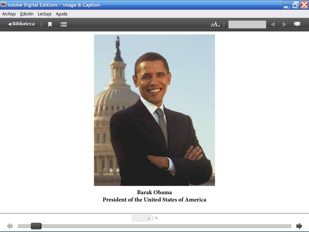

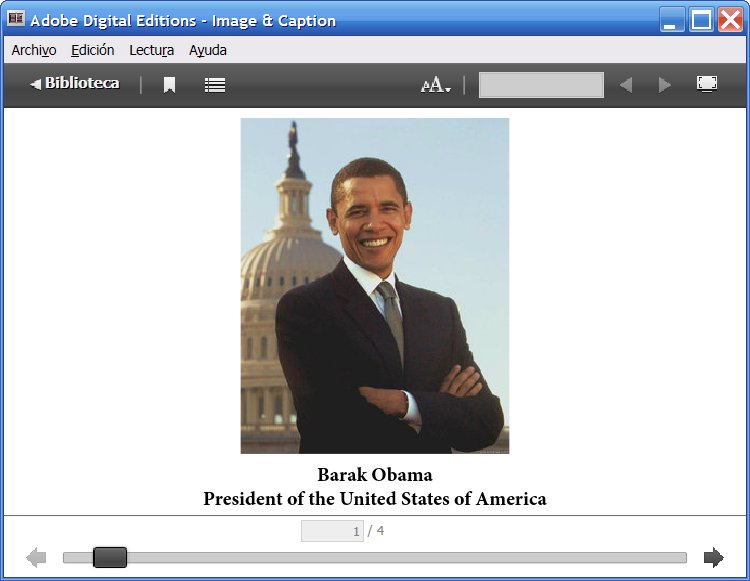

Hi Granny;
In your .css stylesheet, write the following:
html {
    height: 100%;
    margin: 0;
body {
    height: 100%;
    margin: 0;
#container {
    height: 85%;
.img_caption {
    height: 15%;
    text-align:center;
    margin-top: 10px;
    font-weight: bold;
p {
    text-align: justify;
    text-indent: 1em;
    font-size: 1em;
    margin-bottom: 1em;
And in your .html file write this code:
<body>
  <div id="container">
    <svg xmlns="http://www.w3.org/2000/svg" height="100%" preserveAspectRatio="xMidYMid meet" version="1.1" viewBox="0 0 248 310" width="100%" xmlns:xlink="http://www.w3.org/1999/xlink">
      <image height="310" width="248" xlink:href="../Images/Obama.jpg"></image>
    </svg>
  </div>
  <div class="img_caption">
    Barak Obama<br />
    President of the United States of America
  </div>
</body>
Of course, you'll have to adapt the viewBox of your SVG wrapper according to your image. Also take in count that the height of the id "container" plus the height of the class "img_caption" must be equal to 100%. This solution is not so perfect as my solution for the .kf8 format but this one works in ADE
Below I attach screenshots on my ADE and the respective ePub.
Regards
Rubén

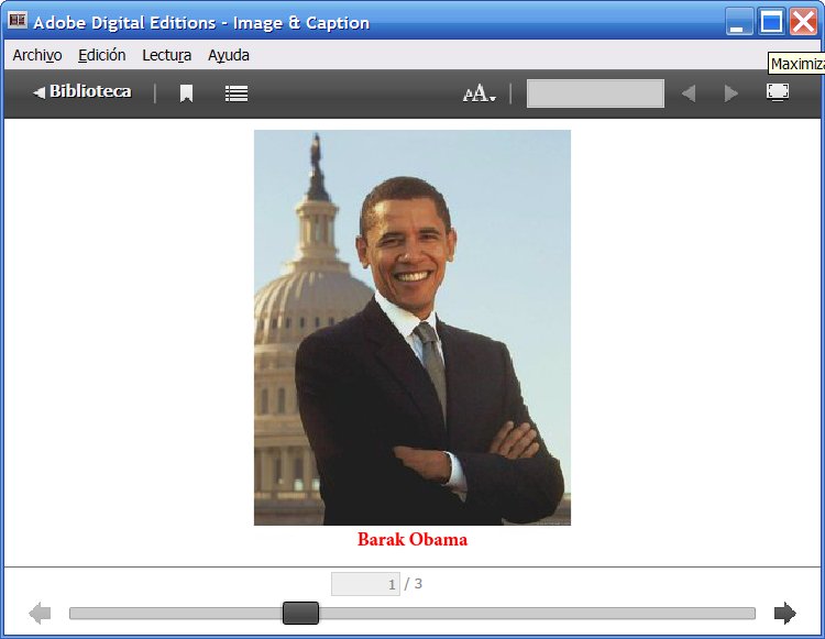

Hi At_Libitum;
Your solution is very elegant but regrettably, has one fail: it doesn't work in ADE
So, the only solution I see is to employ a image with a blank space below and to add the caption in that blank space. See the following:
1. In the .css stylesheet:
p {
    text-indent: 1em;
    font-size: 1em;
    margin-bottom: 1em;
2. In the .html file:
<body>
  <div>
    <svg xmlns="http://www.w3.org/2000/svg" height="100%" preserveAspectRatio="xMidYMid meet" version="1.1" viewBox="0 0 248 340" width="100%" xmlns:xlink="http://www.w3.org/1999/xlink">
      <image height="340" width="248" xlink:href="../Images/Obama.jpg"></image>
      <text text-anchor="middle" x="124" y="325" fill="red" style="font-weight: bold; font-size: 15px">Barak Obama</text>
    </svg>
  </div>
</body>
The original image was 248 x 310 px. With a image processor I modified its canvas size and I added a blank space below of 30px so the new image size is 248 x 340. I added the text in the position y="325" (pixels) and I used a font-size of 15px (so 325 + 15 = 340). Since the original images had a height of 310px, then there is a top margin of 15px for the caption.
To center the text I used the property text-anchor="middle" (as you well pointed out, thank you very much) and a "x" value of 124 (pixels) that is, the half of the image width.
And this time I didn't use a height of 100% for the html and body tag And still works for ADE Below I attach a screenshot of my ADE and the respective epub. I think this time we have the whole solution
Regards
Rubén
