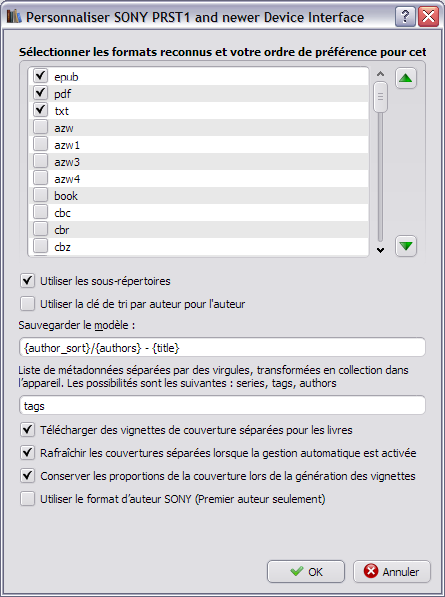

Yep!
Sounds like my first PEz which would error out if I attached it to a Intel 82801 USB2 'enhanced' port, except really much worse than USB1 mode (resorted to installing a separate USB1 only card). My total times were lots quicker: ~6 mins for ~1200 books
What are your Sony device driver settings (screen shot wanted )
Preferences: Plugins: Device Interface: <model>: (click the Customize Button)
What is the setting on Preferences: Sending Books To Device: Automatic Management

Cailbre Preferences is : Sending Books To Device: Automatic Management
For the device, sorry it's in french :-) see attached screen dump.
For the experiment, of course sending to a folder on disk is quite faster and in this case there's no metadata to synchronize with the reader's own database.
USB transfer of the books is 'quite' fast, it's only the metadata which takes ages. Reading/writing through this same port with Explorer shows no particular problems.
