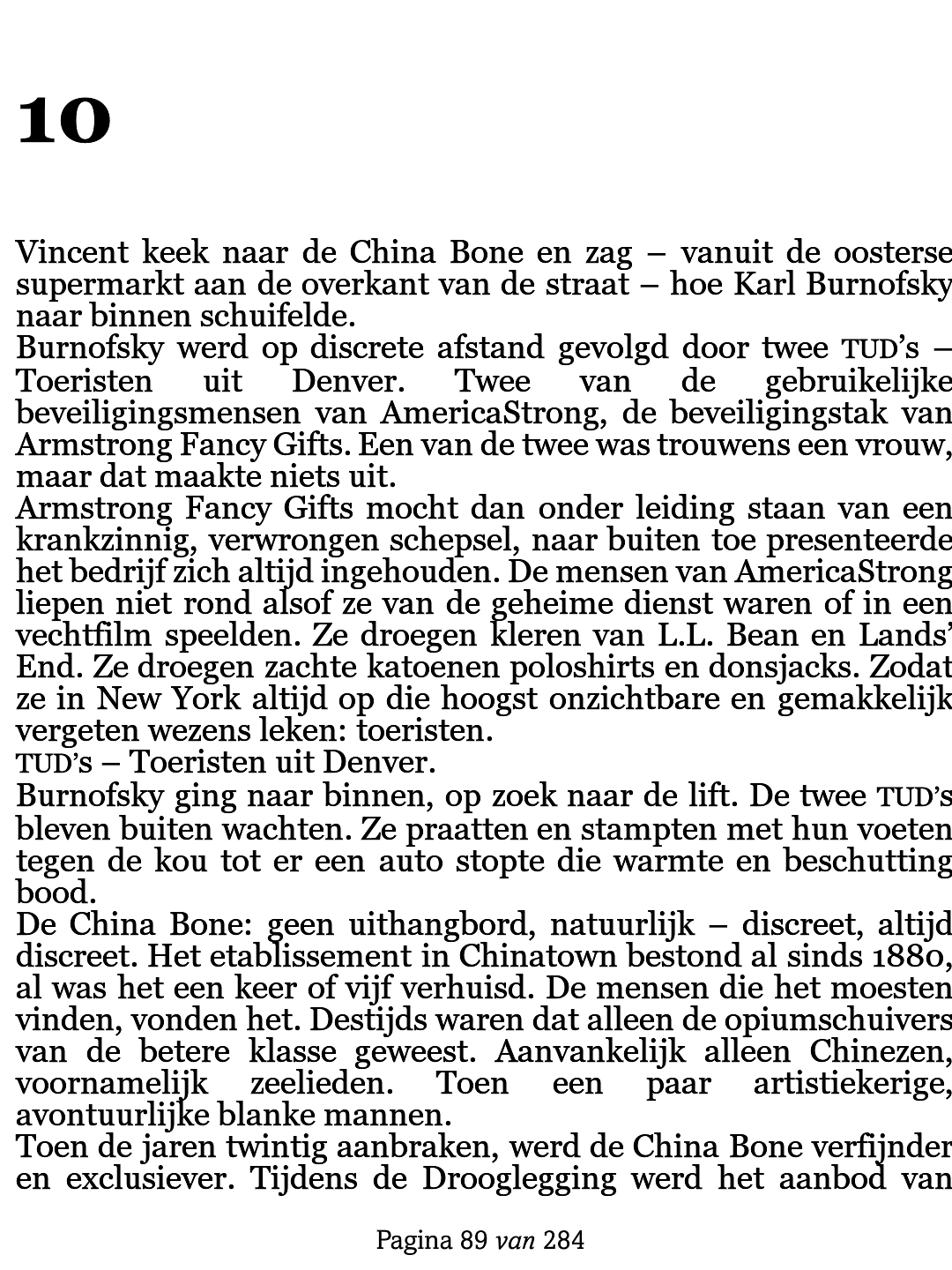

This is my config file for my kobo aura hd and working perfect, but.... it would be great if all books would have 0.5em or 5 pts margins on left and right side.
Is it possible that someone will point me in the right direction ?

When I use the patch Margins fine tuning it works, but then the txt is so much to the right that I must adjust it still,but there is no right margin to be set with a patch.

@Nick,
That isn't what the patch called `Margins fine tuning` is for. Left/Right page margins should be able to be set using the Kobo's adjust Margins slider. If nothing happens when you slide it, it suggests that particular epub's internal css contains left/right margins which are overriding the slider. If you remove them (and I mean remove not set to zero) before transferring to the Kobo, all should be well.
If you're a calibre user you may need to revisit your Preferences for Page Margins and set them to 'No margins' for future conversions. Unfortunately, if the left/right margins are already set in the epub, I don't know of any way other than manual (Sigil or calibre Tweak Ebook) to do the removing.

Sure I can set it by the slider, but it is more easy when it is set automatically ... but for sure, I have to edit almost every e-book that I buy, put off justification, get out with the ugly fonts,remove indents ( I like it all lined up ) get out with line spacing, remove the margins that sometimes make the white space on the page more then 30%, remove the adobe styles pages in /misc.. and before I can do that, the drm.... it is nice to have a reader with all of these features, but without editing the books, you can't use them.. it should be that the reader can override things.. how terrible it must be for people that doesn't know how to use Sigil ?
