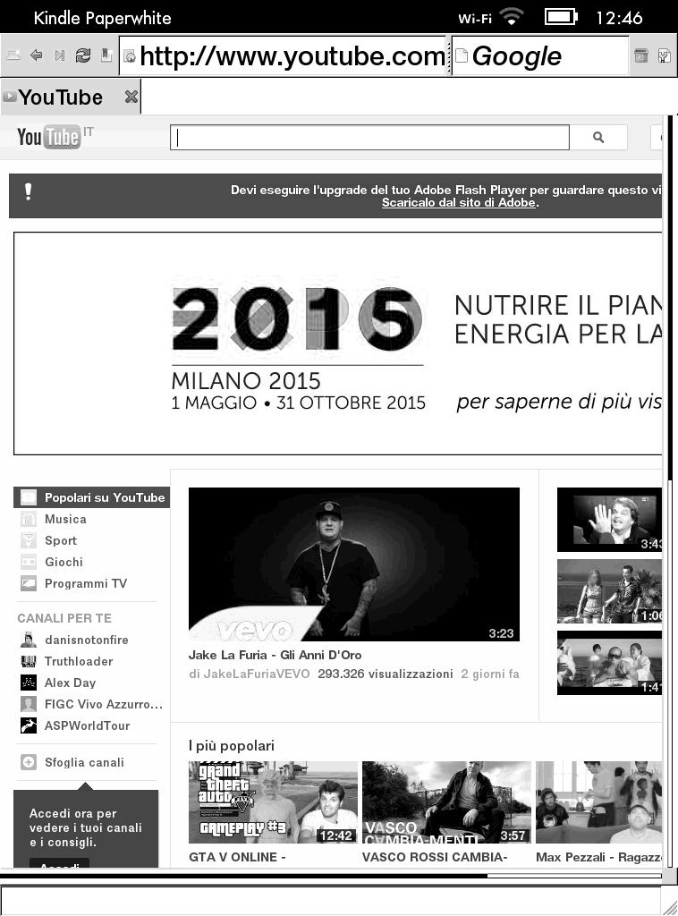

WOWWWWWW! Twobob, this is fantastic!!!! Turned my kindle from a piece of crap into a full featured thing! Thank you so much!!!!
And now testing can begin
One thing: how to exit from preferences if i entered them with kewboard on, and how to exit midori in general?
Suggestion 1: maybe we could focus on the landscape mode version only, what do you think? Avoiding double effort to make interfaces looks good in both modes
Suggestion 2: user impatient like me could click around when midori is loading, making run midori istances in background or avoiding even that midori shows up... I think it would be useful to introduce an automatic "kill all midori istances" in the launch script.
I know this because after closing everything, ps aux command told me that there was a midori istance between processes. A weird thing is also that after i plugged my usb cable with midori running, in the "usb mode on" screen there was also a right click menu from midori O.o
Damn, it's so fast, I love it... And scroll bars works better than any other app. Your masterpiece. Definetly.
