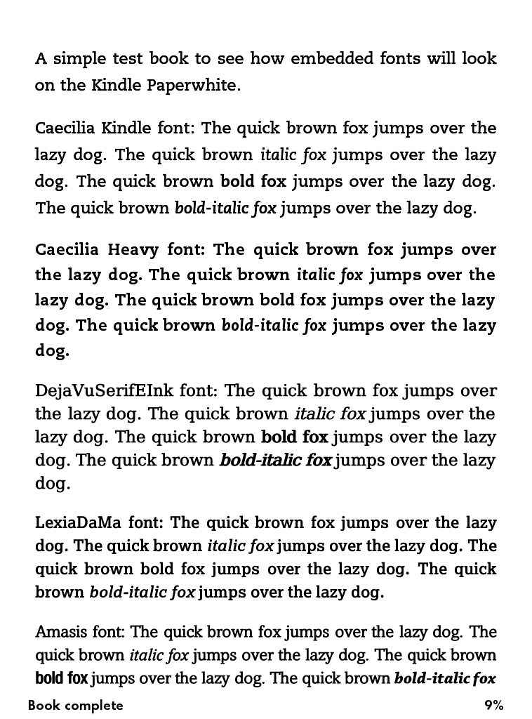

I created a simple test book in Sigil to illustrate how a few different fonts look on the Paperwhite 2nd generation (see attached). I included a short paragraph for each font as follows:
  • Caecilia Kindle font
  • Caecilia Heavy
  • DejaVuSerifEInk (by Katsunami)
  • LexiaDaMa
  • Amasis
I just wanted to see what various fonts would look like on my PW2.
