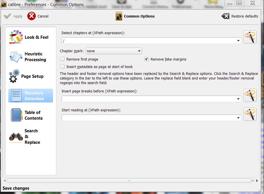

Try changing your settings to match the picture below. (ETA: clearing the "insert page breaks before box" should fix your problem)
If you still can't get it to work, verify that the original file does not have this problem. If the original file is fine, re-add that file to calibre and try again.
That did it!!!!!!!
