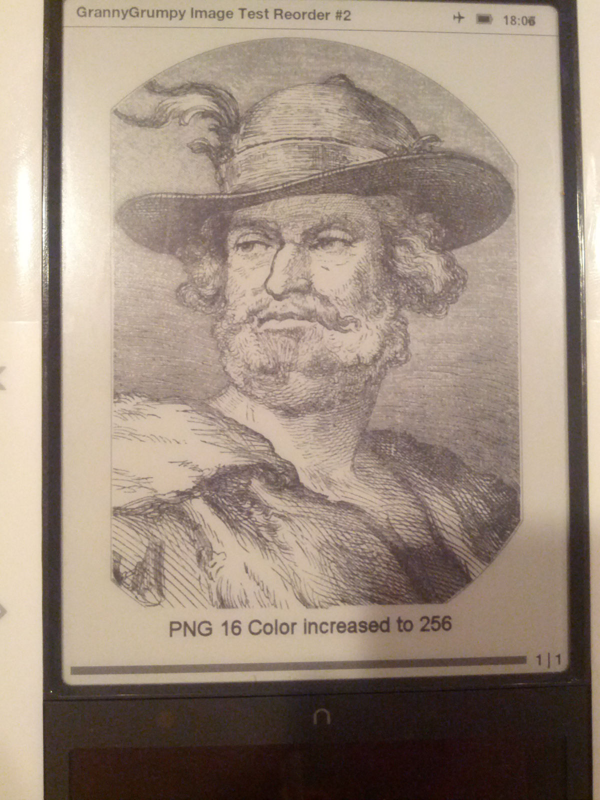

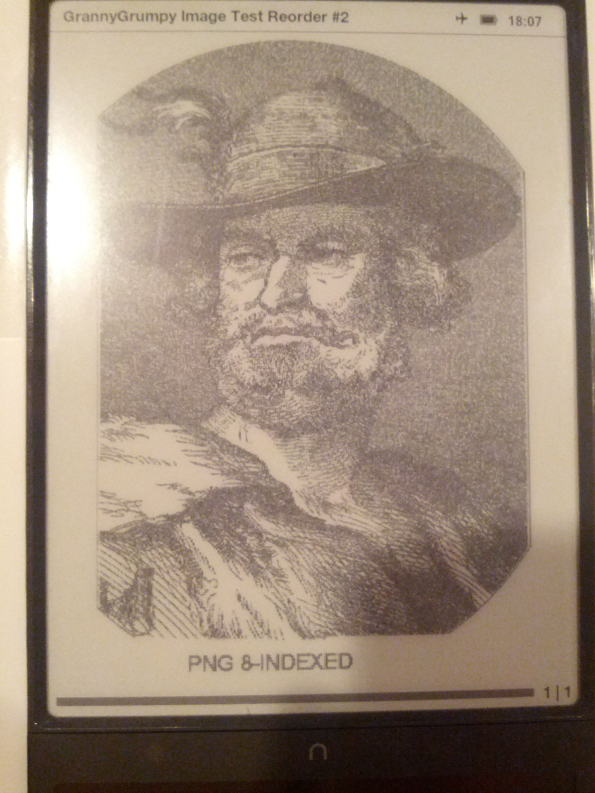

Testing on my Nook:
- In the 16->256->16 section.
-- The only difference is bit-depth (PaintShopPro = 8-bit, GIMP+ScriptPNG = proper 4-bit).
-- My Nook shows weird artifacts (looks like speckling) on the 4-bit images.
ID:	112873 Click image for larger version
- In the Indexed 8 color section, for some weird reason the GIMP version looks EXTRA HORRENDOUS.
-- Your version + ScriptPNG versions look speckled, but otherwise the same.
-- This is odd because they are all 4-bit, so I would have expected that all three would look horrible... so I have no clue.
ID:	112874 Click image for larger version
- There is weird degradation in your image reduced to 16 colors, there is no degradation in the GIMP 16 color version.
-- This is also odd.

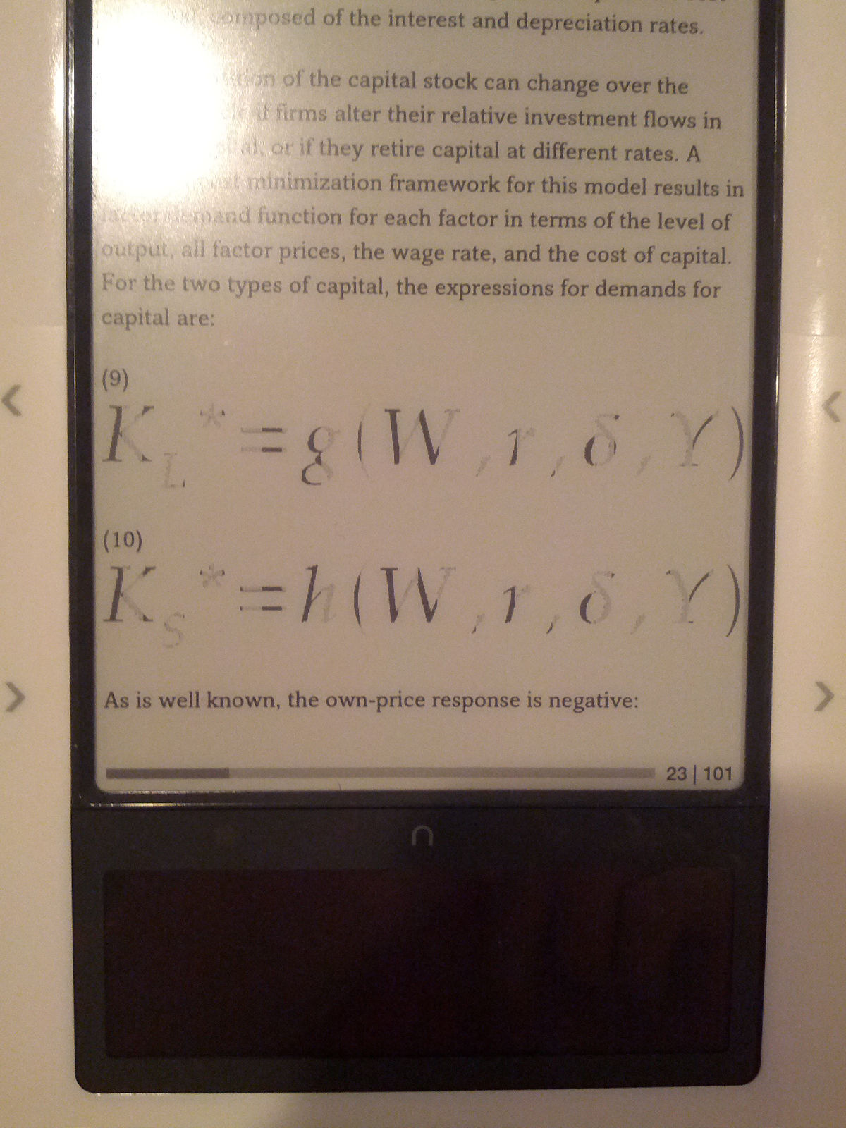

My Image Test EPUB:
OF COURSE I can't get the problem to replicate in my test EPUB consistently NOW... (those gremlins are out to get me lol). But the PNG I was able to get to break was the 2-bit elementof PNG compressed through ScriptPNG:
Here is the problem as I first ran into it in the QJAE (EPUB is attached):
ID:	112878 Click image for larger version
My best guess is... ADE has a bug with 2 and 4-bit PNGs. The "banding" issue is happening on your images, but it is just VERY HARD to tell because of the nature of a photographic image. In my formulas it is much easier to see the bug because there are large swaths of solid color.
Without access to ADE source code, I have no clue exactly what the problem is. I will continue to poke around at the different images with imagemagick... hopefully between comparing all of these different images, I can stumble upon SOME difference. Maybe ADE is ASSUMING 1-bit/8-bit but is ALSO looking at the amount of colors in the PNG, if it falls into those in between ranges, maybe ADE blows up (The amount of colors are saying it should fall into "2-bit/4-bit" while another part of code is forcing it into 8-bit mode?).
This bug COULD have been fixed on a newer version of ADE... could anyone test all of this on a newer e-ink device?
Side Note: Days of work has gone into this. I was reading all this in depth PNG documentation, now time for my brain to explode.
