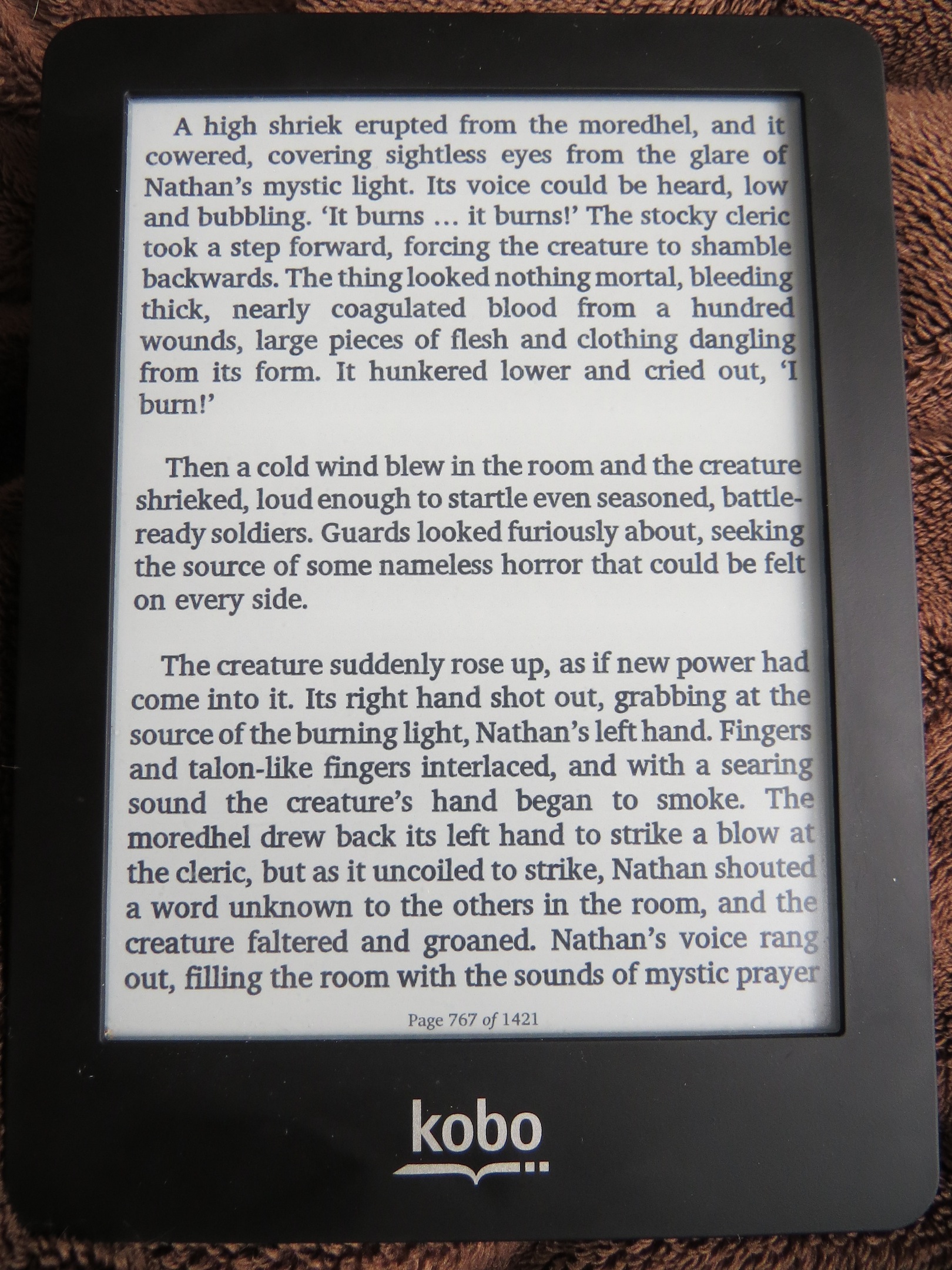

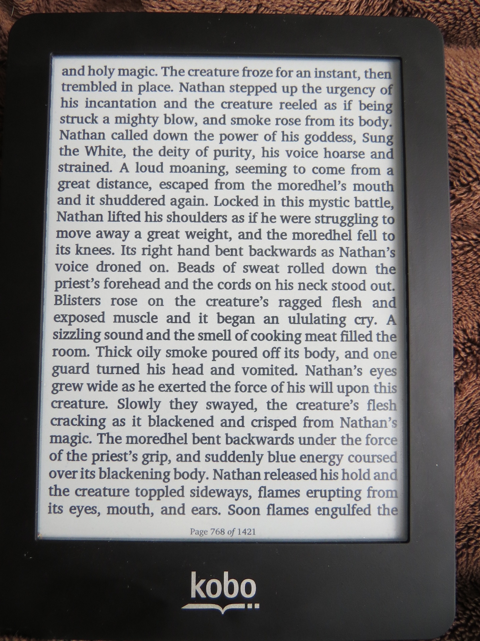

This thread needs more pictures. Evidence that the long paragraph bug is dead! Thanks metazoa!
ID:	111851   Click image for larger version
