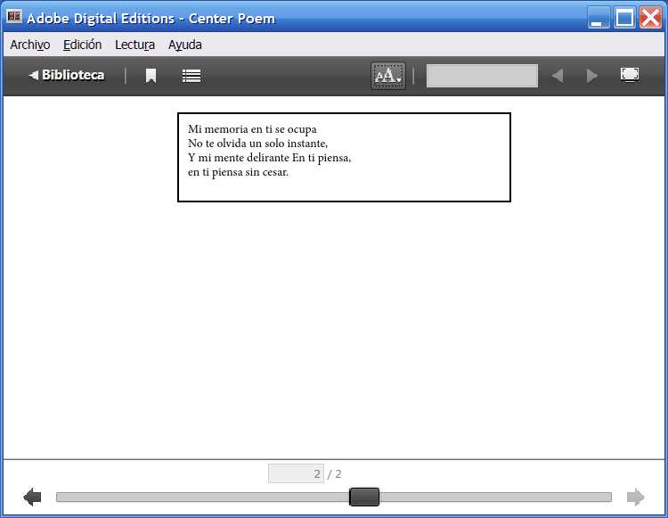

Originally Posted by crutledge View Post
Sorry, I got carried away.
From W3Schools
.centerbox{
width:50%;
padding:10px;
text-indent: 0;
text-align: justify;
font-size : 90%;
margin-left: 25%;
margin-right: 25%;
margin-bottom:1em;
Stanza holds the lines together.
.stanza {
text-indent:0;
margin-bottom:1em;
It seems to work pretty well!!!
Sorry but I'm afraid that is not a complete solution, at least for ADE. The code all it does is to display text with a left margin of 25% of the screen. It could work only if the length of the stanzas is near 50% (or higher). Otherwise, the stanzas won't be shown centered. See the screenshot of my ADE below.
EDIT: I added a border to the .centerbox style, so you can see better what I want to say; the "box" is centered but text inside, not.
Only one of the stanzas need break the 50% mark. A likelihood which is made increasingly more probable when assuming the smaller screen-sizes that people are using for reading.
We've already determined that the perfectly centered block text (100% of the time for all font-sizes) is simply not possible with ADE (currently). All that is left is to forget it altogether, or to come up with a suitable compromise.
Old 09-19-2013, 07:24 PM   #27
RbnJrg
Posts: 1,894
Karma: 8821309
Join Date: Mar 2013
Device: Kindle 4 NT
Yes, right. With one stanza is enough.
OK
