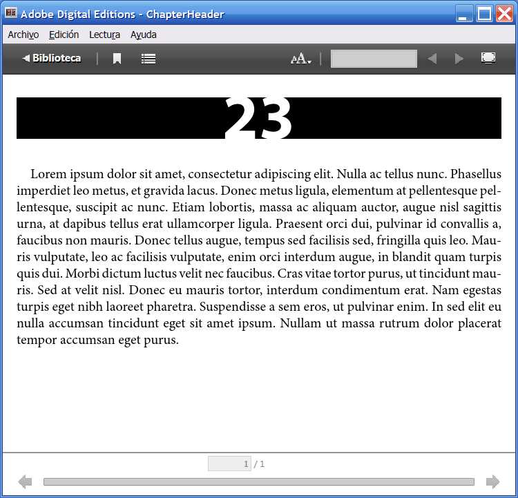

Well, after a bit of work, I could find something that ALSO works in ADE . In your .css stylesheet, write:
h2 {
  height: 60px;
  margin-bottom: 40px;
  background: black;
.text {
  float: left;
  width: 15%; /* this in linked with the left margin below */
  line-height: 100%;
  font-family: sans-serif;
  font-size: 94px;
  text-align: center;
  color: white;
  margin: -10px 0 -10px 42.5%;
And in your .html file write:
<h2><span class="text">23</span></h2>
The text is "floated-centered". I do that by asigning a width to the text block (in this case is 15% but feel free of changing it) and setting a left margin according to that width (in this case, since the width is 15% then the margin-left is [100%-15%]/2 = 42.5%). Also you can play with the font-size and the height of the header (h2).
That's all
Below you can see a screenshot of my ADE and I attach the respective ePub.
Regards
Rubén

Reuben, I've played with your code, using ems instead of px, and it came out quite nicely in ADE. I'm not sure if the height and line height would work on other readers. (probably not, all my ideas lately seem to be too fragile to go hiking around outside of ADE!) It does not look well in Calibre Reader, so probably not good under QT.
h2 {
  height: 1em;
  margin-bottom: .5em;
  background: black;
.text {
  float:left;
  width: 50%;
  line-height: 112%;
  font-size: 2em;
  text-align: center;
  color: white;
  margin: -.25em 0 -.25em 25%;
Thank you so much!
