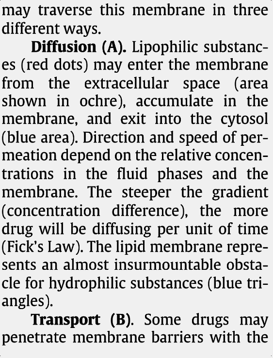

Goodmorning willus. is there a way to reduce a 2 column text when it is too big?
@sage79--Yes. There are some things you can try.
1. k2pdfopt -mode 2col -fc- file.pdf
The -mode 2col will turn on native output. The -fc- turns off the feature that tries to force the column width to your device display width. With this turned off, the column width will be directly controlled by the output DPI (-odpi). If the text is still too large, decrease the output DPI (default is 167):
2. k2pdfopt -mode 2col -fc- -odpi 140 file.pdf
The value 140 is just an example. Use the value that works for you. You can also unwrap the text if you want:
3. k2pdfopt -fc- -wrap+ -odpi 140 file.pdf
This will also unwrap the text in the columns to fill the width of your display, getting more words onto each screen. Note that unwrapping is not compatible with native output, which is why I didn't use -mode 2col.

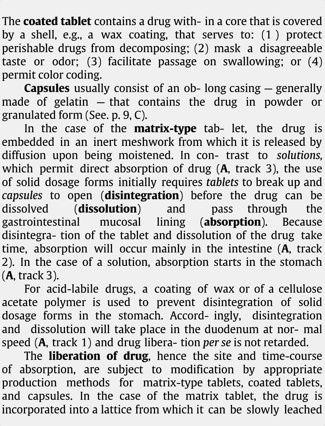

Thanks it works perfectly. It is a great software. And is there a way to remove "-"? -hy parameter don't work.
Can you post a few pages of the source PDF file that you are converting (if you don't want to post it, you can send me a private message)? I'll check out why my hyphen-finding algorithm isn't working on this particular text.
Here is. Thanks. You are very kind.
The hyphens are very clear--the algorithm should find them. I'll check why it isn't working.
