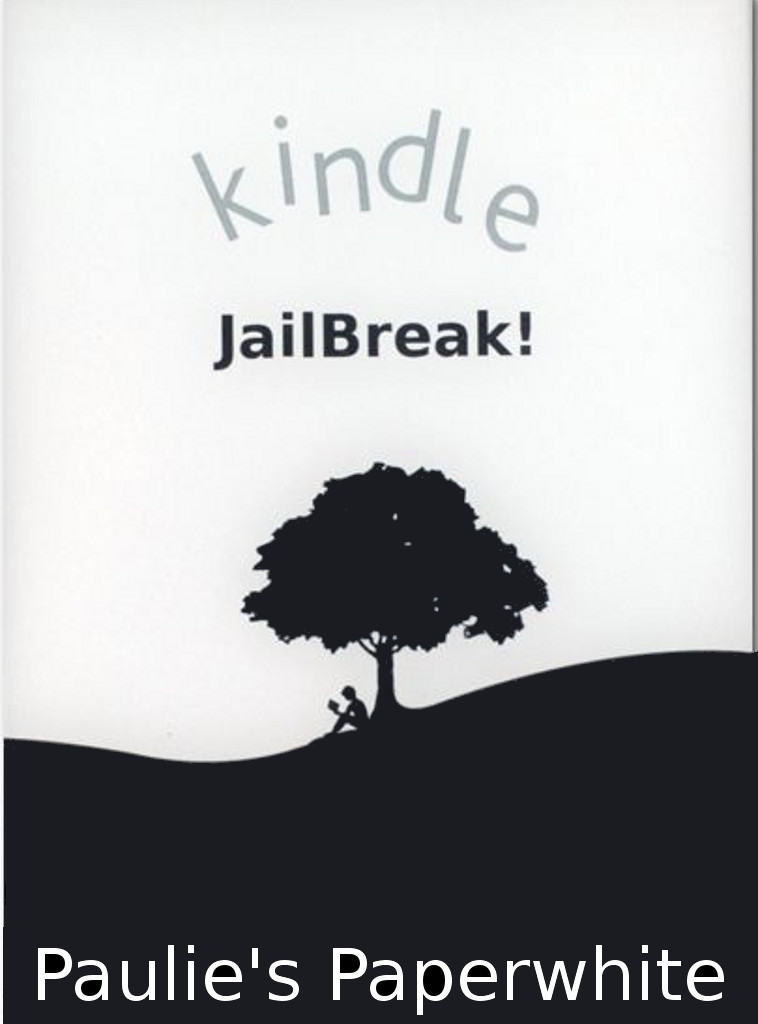

Old 08-28-2013, 06:19 AM   #717
nypaulie
Gātheist
nypaulie ought to be getting tired of karma fortunes by now.nypaulie ought to be getting tired of karma fortunes by now.nypaulie ought to be getting tired of karma fortunes by now.nypaulie ought to be getting tired of karma fortunes by now.nypaulie ought to be getting tired of karma fortunes by now.nypaulie ought to be getting tired of karma fortunes by now.nypaulie ought to be getting tired of karma fortunes by now.nypaulie ought to be getting tired of karma fortunes by now.nypaulie ought to be getting tired of karma fortunes by now.nypaulie ought to be getting tired of karma fortunes by now.nypaulie ought to be getting tired of karma fortunes by now.
Posts: 104
Karma: 205138
Join Date: Jul 2013
Location: MidtownEastNYC
Device: PW2, FireHD6 Gen4
Duh...
**YES**
Sorry if English is not your first language, I thought that sentence answered your question.
Perhaps it should have read: "... choice offered here to make this hack work is for ..."
Or maybe the on-line translator you are using just messed up the translation.
Sorry to have pushed your button with my persistence but after having the SO removed and reinstalling everything (JB, Python & Linkss) I am STILL just getting the woodblock-of-letters screensaver. I had replaced the .png file in the linkss/screensaver folder with my own in .png form and the correct size too.
Getting the one shown on the left - not the one I put into the screensaver directory.

Old 08-28-2013, 07:40 AM   #718
astrodad
astrodad ought to be getting tired of karma fortunes by now.astrodad ought to be getting tired of karma fortunes by now.astrodad ought to be getting tired of karma fortunes by now.astrodad ought to be getting tired of karma fortunes by now.astrodad ought to be getting tired of karma fortunes by now.astrodad ought to be getting tired of karma fortunes by now.astrodad ought to be getting tired of karma fortunes by now.astrodad ought to be getting tired of karma fortunes by now.astrodad ought to be getting tired of karma fortunes by now.astrodad ought to be getting tired of karma fortunes by now.astrodad ought to be getting tired of karma fortunes by now.
astrodad's Avatar
Posts: 963
Karma: 568242
Device: Kindle Oasis 3, Kindle Paperwhite 1, iPad, iPhone
Are you sure you are disconnecting the USB cable when performing the installs?
astrodad is offline   Reply With Quote
Old 08-28-2013, 08:12 AM   #719
ixtab
(offline)
ixtab ought to be getting tired of karma fortunes by now.ixtab ought to be getting tired of karma fortunes by now.ixtab ought to be getting tired of karma fortunes by now.ixtab ought to be getting tired of karma fortunes by now.ixtab ought to be getting tired of karma fortunes by now.ixtab ought to be getting tired of karma fortunes by now.ixtab ought to be getting tired of karma fortunes by now.ixtab ought to be getting tired of karma fortunes by now.ixtab ought to be getting tired of karma fortunes by now.ixtab ought to be getting tired of karma fortunes by now.ixtab ought to be getting tired of karma fortunes by now.
ixtab's Avatar
Posts: 2,907
Karma: 6736094
Device: K3, K4, K5, KPW, KPW2
nypaulie: Read the text on the left image. Your device still thinks it is SO-enabled. Make sure you have let it phone home. If that doesn't help, contact Amazon CS.
