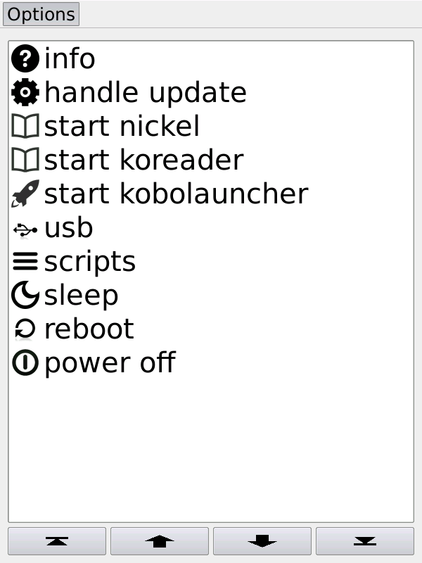

Since I mentioned the example application in another thread today, I would like to say that I am testing now a newer version and will upload it soon. Therefore, I discourage anybody from installing the older version at this point. I add an image of the first screen of the new version.
it looks really cute!
