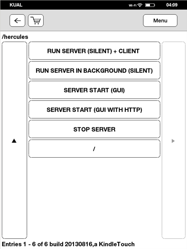

EDIT: (version 0.2)
Now includes a Client and several variations of boot.
The top button is the one most users would want.
Server (SILENT) + Client

[root@kindle root]# LD_LIBRARY_PATH=/mnt/us/extensions/hercules/lib/hercules:$LD
_LIBRARY_PATH /mnt/us/extensions/hercules/bin/hercules
Hercules Version 3.07
(c)Copyright 1999-2010 by Roger Bowler, Jan Jaeger, and others
Built on Jun 18 2011 at 16:18:09
Build information:
Debian
Modes: S/370 ESA/390 z/Arch
Max CPU Engines: 8
Using setresuid() for setting privileges
Dynamic loading support
Using shared libraries
HTTP Server support
Regular Expressions support
Automatic Operator support
National Language Support
Machine dependent assists: (none)
Running on kindle Linux-2.6.31-rt11-lab126.#1 Tue Jul 17 16:55:47 PDT 2012 armv7l UP
HHCHD018I Loadable module directory is /usr/lib/hercules
Crypto module loaded (c) Copyright Bernard van der Helm, 2003-2010
Active: Message Security Assist
Message Security Assist Extension 1
Message Security Assist Extension 2
HHCCF003S Open error file hercules.cnf: No such file or directory
HHCIN900I Begin Hercules shutdown
HHCIN901I Releasing configuration
HHCIN902I Configuration release complete
HHCIN903I Calling termination routines
HHCHD900I Begin shutdown sequence
HHCHD901I Calling hdl_term
HHCHD950I Begin HDL termination sequence
HHCHD951I Calling module *Hercules cleanup routine
HHCHD952I Module *Hercules cleanup complete
HHCHD959I HDL Termination sequence complete
HHCHD902I hdl_term complete
HHCHD901I Calling logger_term
HHCLG014I logger thread terminating
HHCHD902I logger_term complete
HHCHD909I Shutdown sequence complete
HHCIN904I All termination routines complete
HHCIN909I Hercules shutdown complete
Getting there

Success
_LIBRARY_PATH /mnt/us/extensions/hercules/bin/hercules -f /mnt/us/extensions/hercules/hercules.cnf
Build information:
  Debian
  Max CPU Engines: 8
  HTTP Server support
HHCHT001I HTTP listener thread started: tid=40B8F470, pid=5539
HHCCF066E Invalid HTTPROOT: "/usr/share/hercules/": No such file or directory
HHCCF065I Hercules: tid=4001D1F0, pid=5539, pgid=5539, priority=0
HHCRD010E Unable to access file "./util/zzsacard.bin": No such file or directory
HHCCF044E Initialization failed for device 000C
HHCTE001I Console connection thread started: tid=40B8F470, pid=5539
HHCTE003I Waiting for console connection on port 3270

Old 08-20-2013, 12:09 PM   #11
twobob
( ͡° ͜ʖ ͡°){ʇlnɐɟ ƃǝs}Tır
twobob's Avatar
Posts: 6,586
Karma: 6299993
Join Date: Jun 2012
Question...
Shall I dynamically create that /usr/share/hercules/ and loopmount to the FAT?
Oh and I got the
Error fixed up... Whatever that was for.
Old 08-20-2013, 12:21 PM   #12
knc1
Going Viral
knc1's Avatar
Posts: 17,212
Karma: 18210809
Location: Central Texas
Device: No K1, PW2, KV, KOA
Originally Posted by PoP View Post
Why? Because you can!
You guys are amazing
BTW I used to work on IBM/1401 and IBM/1130... The 360's and after are an ambitious project.
Well, a small installation looked like this:
Not only did they not include the swivel chair, unlike the Kindle, they didn't make available a padded, zipper case.
Old 08-20-2013, 12:29 PM   #13
knc1
Going Viral
knc1's Avatar
Posts: 17,212
Karma: 18210809
Question...
Oh and I got the
I am not sure of that one - than may be where the OS is supposed to live.
The "success dump" shows that the "mainframe firmware" is ready to accept an IPL (or other) command to load the OS.
Check the Herc site, faq section, with links to a lot of "HowTo" continue beyond the IPL (Initial Program Load) command prompt.
Geesh, where is Geekmaster when you need him?
( He needs IBM Cobol for his day job.)
Translation:
Box it and Ship it as-is.
It is ready for the addition of user's choice of OS package (see my dream-link above).

Old 08-20-2013, 12:41 PM   #15
twobob
twobob's Avatar
Posts: 6,586
Karma: 6299993
Join Date: Jun 2012
Yeah....
The config line:
HTTPROOT /mnt/us/extensions/hercules/share/hercules # HTTP root directory
refuses to be serviced... for whatever reason?
So... Ill package it. as-is. with a link to
http://www.ibiblio.org/jmaynard/turnkey-mvs-3.zip
as you kindly suggest.
And then move onto Win95
[root@kindle hercules]# cd /mnt/us/extensions/hercules/; LD_LIBRARY_PATH=/mnt/us/extensions/hercules/lib/hercules:$LD_LIBRARY_PATH /mnt/us/extensions/hercules/bin/hercules -f /mnt/us/extensions/hercules/hercules.cnf

CPU0000 PSW=0000000000000000 24M....... instcount=0
But yeah. Works great. (I think)
When I package it up: Maybe add the OPTION to loopmount the "Invalid HTTPROOT:" to something sensible.? Or perhaps I'll just hardcode that.
the impact on the "Root" will be the creation of one innocuous folder.
Hardly devastating.
