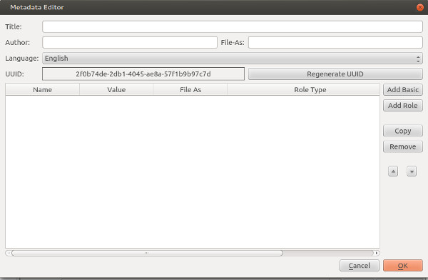

Frustrated with Toxaris CleanHtml macro (I certainly don't intend to learn MS VBA only to do the same thing in LO VBA ), I decided to do something else where I can make a complete fool of myself .
I find default.epub a "must have" feature - so comfortable changing of unique ID would be a nice thing - so I went into Sigil source.
It was a little bigger journey than assumed... but it's my first venture into C++ (and Qt!) - so perhaps I exaggerate.
It would be nice if Devs would take a look at it and point out what I did wrong (ncx thing?). Nevertheless it works so far and I intend to use it!
So here is the patch to official git commit 9e50f3c7c405a4272eb5e3d76e92f1a879b9b027 (at the moment latest) . I've put this thing into Metadata Editor, picture attached.
It uses standard Sigil method to generate new unique uuid.
usage (linux): cp /whatever/reuuid.patch /yourSigilGitFolder/. ; cd /yourSigilGitFolder; patch -p1 < reuuid.patch ; compile as usual.
Of course making default.epub settings standard by Sigil File->New menu item would be better solution but at the moment it's not a journey I'm willing to take.

I don't know what this has to do with it, but fine. Don't get frustrated when something created for program A does not work on program B...
Good work on the UUID patch I guess. Never run into it myself, but if I look at the thread there is some demand for it.

I like to suggest this feature:
[x] No creation of an UUID, if an ISBN or another ID exist in the metadata
[x] Delete UUID, if an ISBN or another ID is entered in the metada
Of course inside the ISBN (or other ID) entry
id="book-id" (or BookID - I prefer it, when all values are in small letters)
has to be added.
What do you think of it, please?
