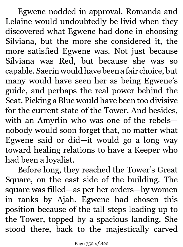

If anyone cares to see, I've attached a screenshot.
Thanks again, I really appreciate the help, especially as a new member.
Keith

I also have things mostly working at this point. One thing I can pass along, be careful what epub you use for testing. I think the Kobo has some quirky rendering. My test book had every para nested in a div (don't ask my why). This shouldn't have mattered, but it turns out it was causing extra space on the Kobo that I mistakenly thought was a problem with the settings in the patch, and I wasted a lot of time fiddling with settings.
Once I tried a few other books with regular paras for markup, I got results like the screen capture in post #13 of this thread.
