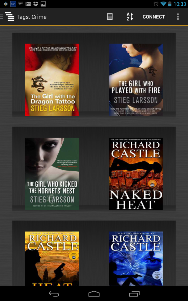

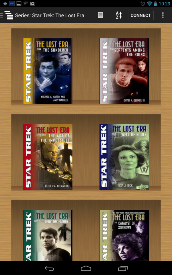

The third beta looks good.
I could not replicate my previously reported image anomaly. Switching between portrait and landscape in the cover grid now maintains its position. The Authors, Tags and Series now append what is selected in the closed (or open) drawer. It still connects fine and books transfer as expected.
Plus I finally have a cover large enough using the square box preserve aspect ratio setting that does not require me to wear my reading glasses.
ID:	109478   Click image for larger version
ID:	109479   Click image for larger version

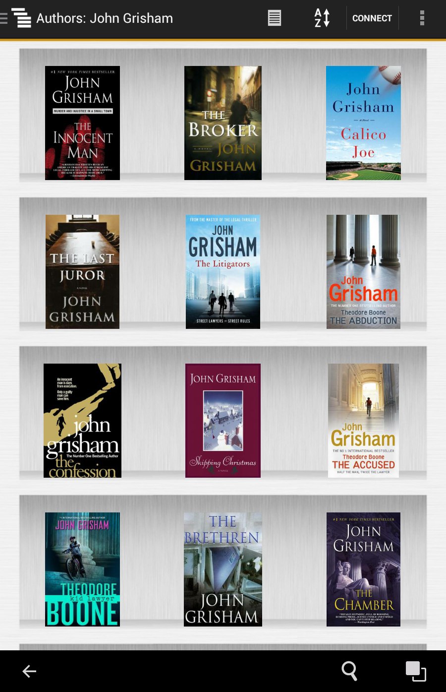

Charles ... The issue first reported by Purple Lady still exists on my device. See attached shots.
However, keep in mind I would never have even known about it had I not read this thread and tried to replicate it. It really doesn't impact me. I keep my device locked in portrait mode and only rarely (for games, movies) take it out of that orientation.
I just thought you might like to know.
I really like having the tag show in the grid view. It's easier than opening the drawer to see what tag it is. I was thinking of asking for something like this earlier but didn't want to be too greedy. Also, I could live without it, but it's nicer to have it there.
The large thumbs now show as larger than medium in square/AR mode. However since only 2 books fit across with this change I decided to stick with the medium-size thumbnails.
Thanks again for your receptive ear(s).
--Pat
ID:	109502   Click image for larger version
