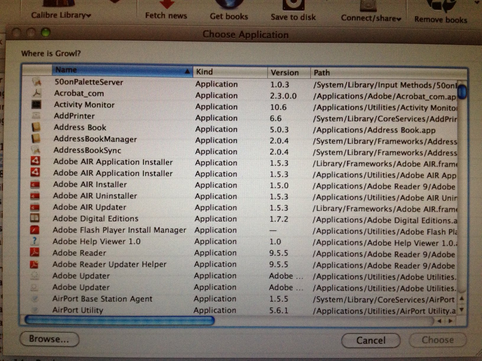

This is exactly what I have been doing. After I add the new book, I select the new book and click convert individually. Then a dialogue box pops up telling me to choose an application. I don't know a better way of explaining it, so I've attached a photo of this pop-up.

After this dialogue box opens, I attempted to choose Calibre as the application and that's when Calibre crashes.
Something is corrupt. This pop-up should not be opening and certainly selecting anything in it will cause havoc.
I'm not an OSX experienced user, but I would suggest uninstalling calibre and deleting the associated downloaded update. Then re-download a new copy from here and try again.

Go to Preferences->Look & Feel and disable system tray notifications.
So OSX uses Growl for notifications. Even though I'm not a OSX user I should have noted what it was asking.
Always learn something new here.
Old 08-14-2013, 04:48 AM   #11
Posts: 46,585
Karma: 29634066
To be precise, older versions of OS X used Growl. Newer ones have notifications built-in. The OP's system probably has some debris left over from a previous growl install/removal that is causing the issue.
Thanks for the info.
I still should have noticed, to busy changing the OP's graphic to right side up. If I had a pop up asking me where growl was I certainly would not point it to calibre. Then again maybe I would have pointed to calibre. I mean since I didn't see it correctly here there is no reason to believe I would have seen correctly it live.
Brilliant! This worked!
Oddly, though, now my conversions are taking roughly 10 minutes each. I did it twice to be sure, and they both sounded like they were chugging through the conversion. I suspect maybe this is a hardware issue although this never happened with the earlier version of Calibre. Oh well! I'm ecstatic it's working again.
