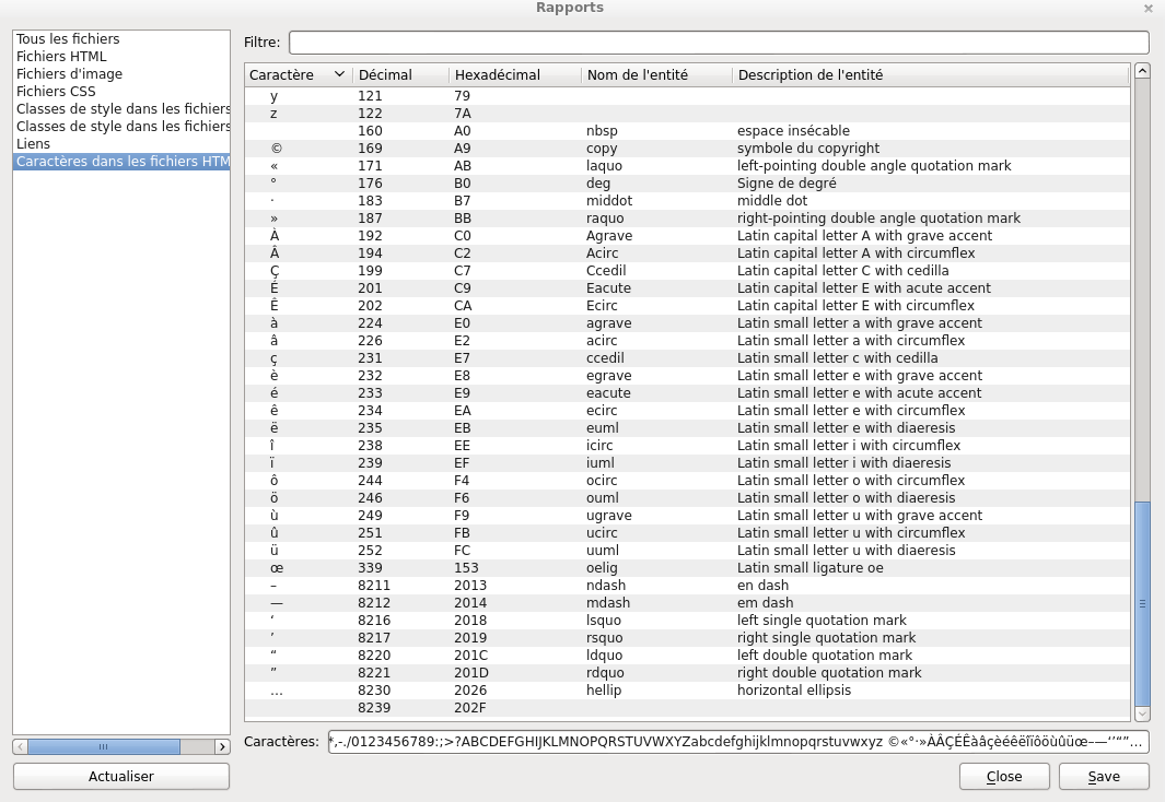

To my shame, I never used the "report" feature of Sigil and it's indeed a nice one. You have trouble displaying French (mostly) characters - à, é, è, ô, etc.
I show you part of my report (figure one), how ô is displayed in
code view (arrow as an example in fig 2) but also é, è, à, and the declaration I use for every xhtml file (Note).
I make no use of a complicated translation table for entities. It all goes smoothly and displays conveniently all French characters. Maybe this could help.

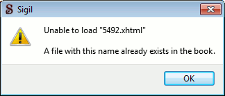

Duplicate HTML files Overwrite:
When adding duplicate XHTML files, you get this dialog:
You have zero choice in what you want to do (in this case I want to overwrite, but I just have to press "ok"). This dialog also falls into having to click "ok" tens/hundreds of times. Most of the time I just kill Sigil, instead of dealing with hurting my mouse finger.
This dialog can also benefit from an "Overwrite", "Overwrite All", "Ok" choice. Or maybe it can complain and in one shot just give a list of files it cannot insert.
Currently, I either:
1. Open the EPUB in 7-zip, overwrite the XHTML files manually, and then reopen the EPUB in Sigil and continue working.
2. Use Sigil to mass delete all the XHTML, then add all the XHTML again using Sigil.

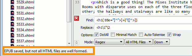

Currently while you are in Sigil, and try to save when you have a malformed document in your EPUB, it is very hard to tell which file is the exact culprit. Perhaps this sentence can have at least some mention of which HTML file is causing the problem:
"EPUB saved, but not all HTML files are well formed: 5396.xhtml"

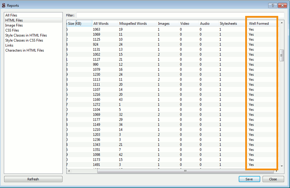

HTML File Report Problem (?)
Also, this column in the HTML Files Report seems to be me to be worthless. You cannot get into Reports unless the files are all well formed.
